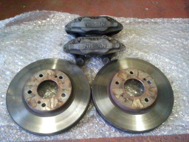

Ive got a pair of tt front discs and calipers and a pair of braided steel brakelines I can do you for £140 + postage :)

Discs are in good condition and weren't.on for that long as changed mine to the 350z brembo setup.
[ATTACH=CONFIG]64857[/ATTACH]
