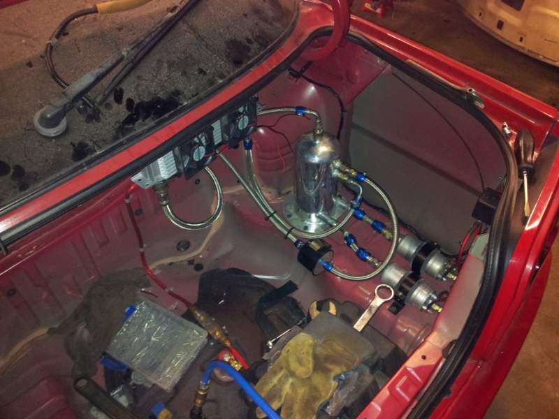

Thanks guys :) Eggs im looking to install a 2ltr fuel swirl pot that the stock pump will fill then from the pot twin bosch 044 pumps will feed each rail. The fuel will also run though a fuel cooler with twin electric fans.
Here is the kit..its a bit over kill as it capable a 1000bhp. Id rather have the choice to have to much pressure that i can adjust than not enough.
Cheers Dan
