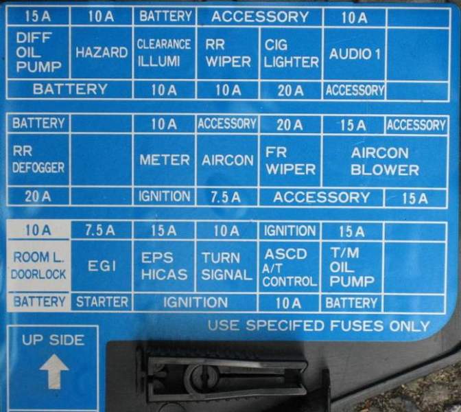

you say you have checked the fuses, have you checked the ones in the drivers footwell?. near where you right foot would be, about 10" up from the floor, check the top row to start, usually 10amp 3rd in, has issues that will effect most of this stuff. if you have, then check for water ingress via the front targa drain tube, (if you have targas) as the silicone pipe may have come undone, and water is now emptying into the rear of the fuse box.
If these are a no no, then i would be looking around passengers footwell around the ecu for the same.
if these fail, it could be a long drawn out job, as it sounds you have a short somewhere.
hope this helps.
Its dry as a babies bottom
Yes checked and swapped fuses in drivers well, and two pockets of fuses under hood.
Are there any more fuses anywhere?
Im thinking short but how can i diagnose locate or confirm this. Checked the cigerette lighter wiring. Ground ok, illumination ok, battery permanent ok, ignition live doesnt work...so im thinking its this ignition wire which runs all of my issues and the issue is further fown this wire...but i dont know what to do now yo test this.
Everything on the heater pod is run from the accessory circuit ( position one on the key) this is activated from a relay on the back of the footwell fusebox, this can fail and cause the exact problem your having.
The cig lighter is also on the same supply so you need to get the accessory circuit working again, fuse box out job which is a pain on the ass but no other way around it.

Ist picture is the front of the fusebox which is the bit you can see when looking in the drivers footwell area, the second picture is the rear of the fusebox that can only be seen after removal.
