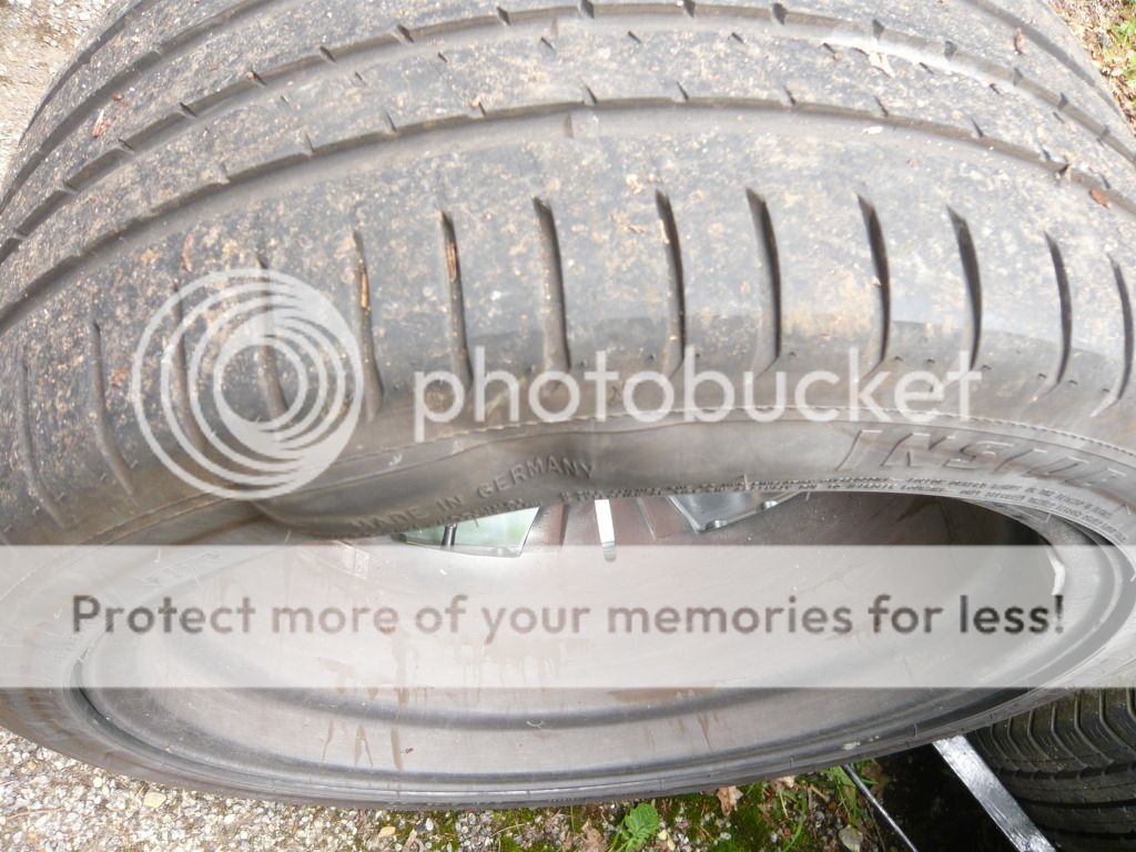

Took the back wheels off this afternoon to investigate a strange noise.......:no:

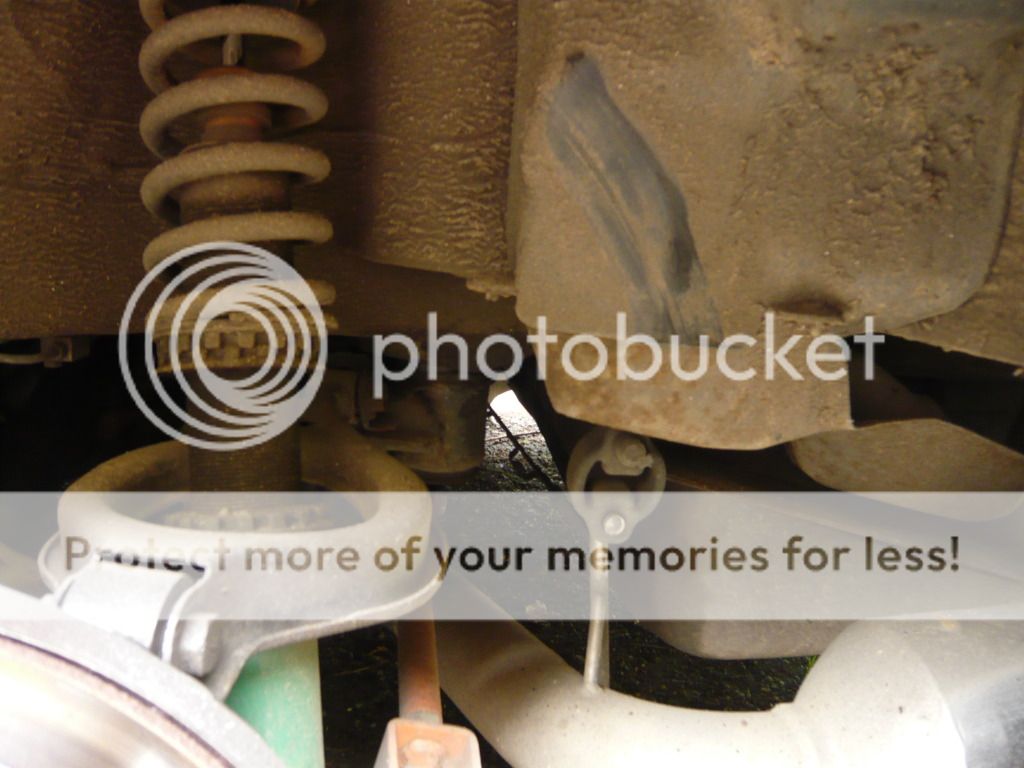

Pass side has been rubbing on the fuel filler gaurd
The tyres are 265/35/18. Are these too wide?
The rims are 18-9JJ, so the question is, do I get thinner tyres like 255? adjust the plastic gaurd or fit a spacer?
The annoying thing is that I have 2 front tyres on order as I wanted to match the rear :headvswal
At least I spotted it though as I wouldnt want that going pop along the motorway..
Looks to me like the tyre size is ok, you just have a damaged/faulty tyre.
I have 275/19 on the back and no problem with contact like that. looks like the tyres have just tennis-balled.
And I suppose there is no chance of saying they were faulty?
Only 6 months old!!
LOL... six months old... yeah, I'd be taking them back.... good luck..
