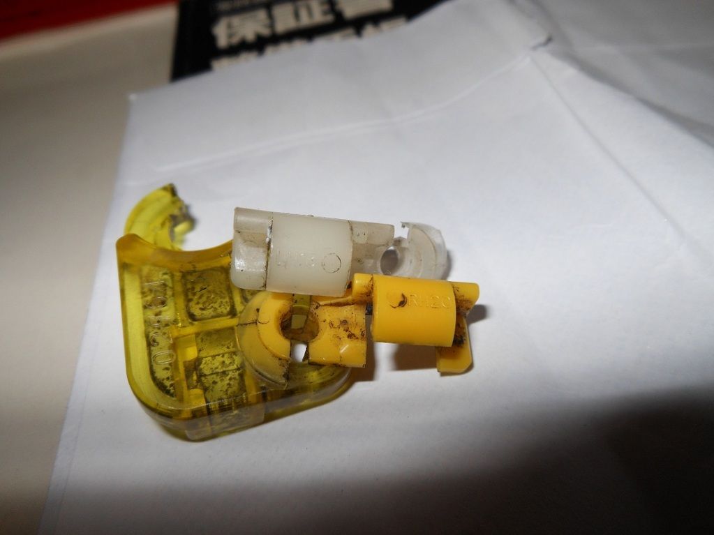

Today I managed to get the door card of the drivers door, to start looking at exactly what the problem was. I found it was the catch which is directly attached to the lock and a true pain in the butt to reach. Nonetheless, I managed to locate it and remove the problem catch as shown below:
As you can see at the top of the clip, it should be a complete circle, which attaches to the back of the "key hole". Unfortunately it has cracked, and needs to be replaced.

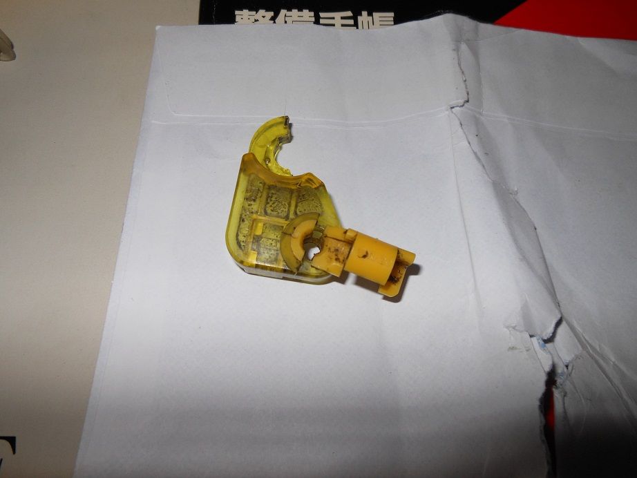

As You can see in the picture below, the clip which connects the snapped clip and the door mechanisms "bar" is available in white and yellow. Im assuming yellow is always the Right Hand Side, (UKDM, JDM Drivers Side, USDM Passenger Side) and white on the other. I have noticed they have a LH / RH marking on them as seen here:
Anyway, if anyone has a "yellow" locking clip spare as shown in the second picture (but not broken of course lol) I would highly appreciate it, as I currently have the drivers door panel of, (which was a pig - untill I realised what I needed to do!) I will get a guide up, soon as I have completed the repair.

Mine broke in the black zed so I got a steel washer and stuck it to the broken part using araldite. locked fixed.

No harm in trying, did you have to "file" two divets for it, as on the plastic clip, it looks as though it has two divets, I guess to give it something to grip to as you turn it.
Will take it down DIY store in the week, try get a washer that fits.
