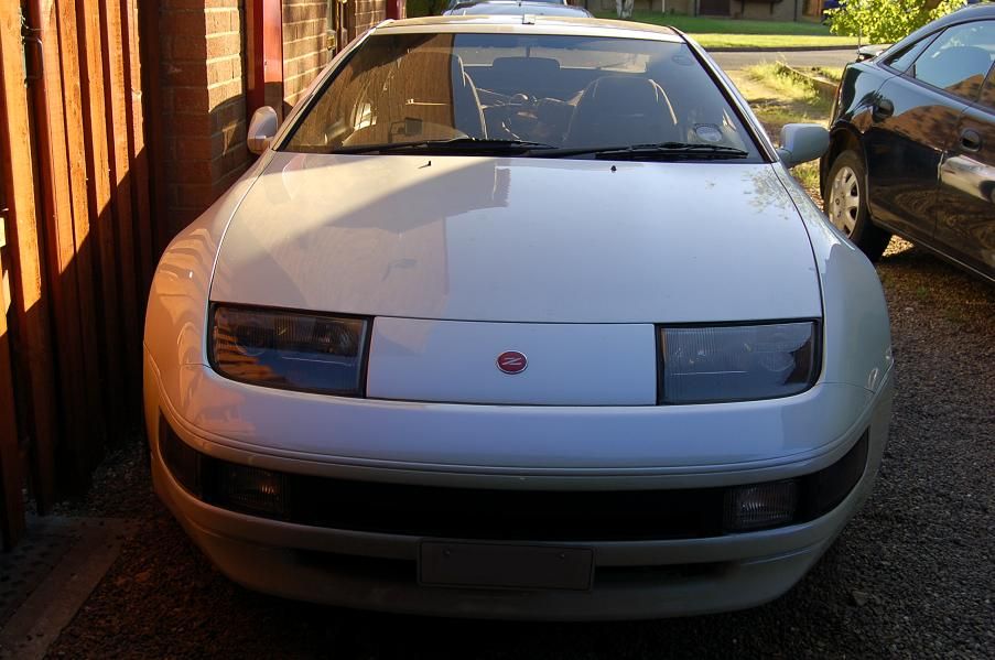

And she's a beauty :) cant wait to get some better pics of her really showing off her fresh pearly paint :)
I do mate, my TT's been sitting for two years. lol
that looks great mate, what are your plans for her?
