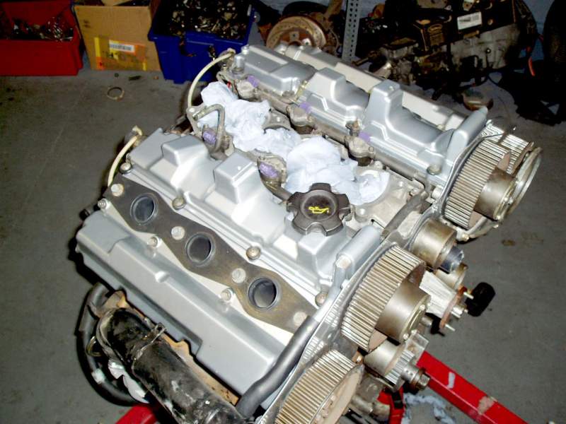

can anyone tell if these pulleys are orthadox racing underdrive Pulleys??

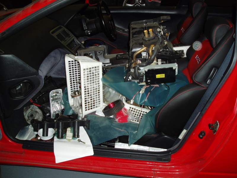

car had then fitted when it went in to zxtreme i seem to remember they were anodised red and i had to get a sepearte set of belts for them,
and then the car at zedworld there seems to be one on the seat , i know they were all there , but these fitted dont look the same .....im now wondering about my fidenza lightened flywheel and rps street max clutch if theyre fitted ..i have PM'd jeff but no reply.....any ideas fellas s2.jpg
thing is i cant tell if theyr fitted or not without lifting the engine out or dropping the gearbox and we all know what it slike taking the cam covers off .......how can i tell if theyre orthadox....these seem to have nissan stamped on them.....
You mean "unorthodox" pullies mate? if so they go OUTSIDE the cam covers at the bottom. Your pic shows the cam/exhaust sprockets behind the covers and even remanufactured/aftermarket ones usually have Nissan stamped on them, unless you paid mega money for some Jap branded ones.
