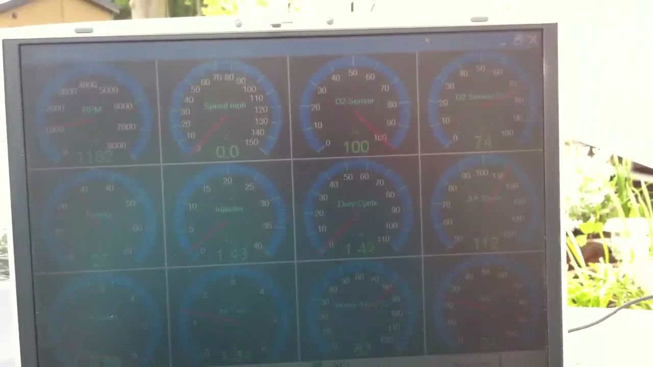

Have you managed to run the tests yet? really interested...
Yeah, but it stopped being rough when I went for it. It's sporadic.
d3e90616.mp4
Membership No 0780
INSURANCE GOOFA
On first glance, your TPS is a little high set it to 0.44v (don't forget to pull the lead for 10secs while engine running to reset). After you've done that the idle looks to be high as well wind the screw back to bring it down to 750rpm.

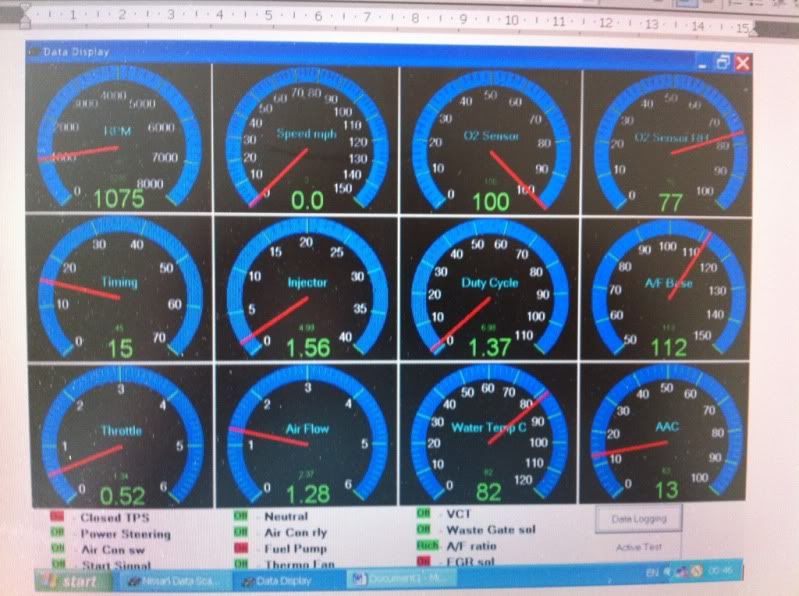

Change the tps, seems to be running a lot smoother now.
Revs are still sitting around te 1k mark but I'll run it a few times before I change revs down slightly.
Do you think anything else seems out?
The O2 sensors are moving back and forth, the left one seems to go between 30-100 and the other goes from 20-60. This is when revs are just over 2k
Does that seem okay?
Heres the current reading...
