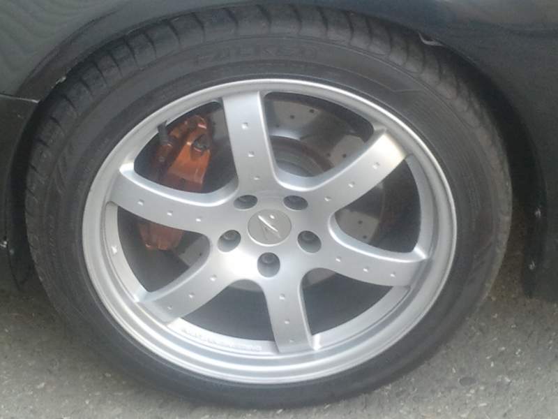

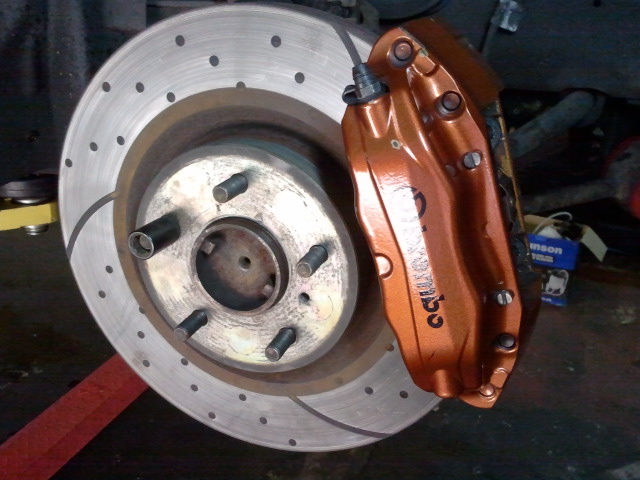

350z front Brembo setup is easy to fit, just need to drill caliper bolt holes on the hub from 12mm to 14mm.heres mine with 18" forged Rays from a 350 :)
