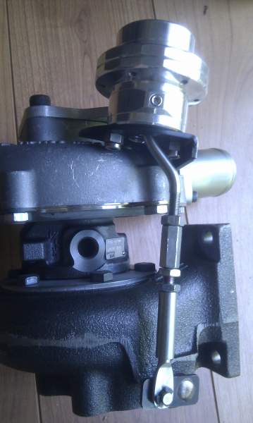

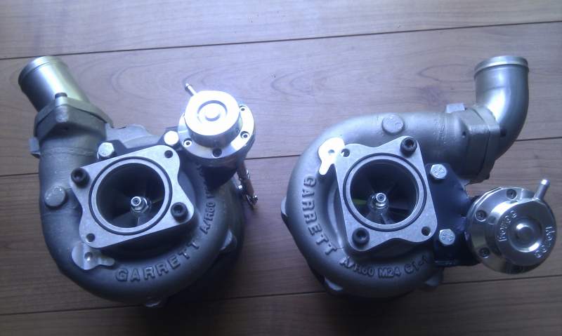

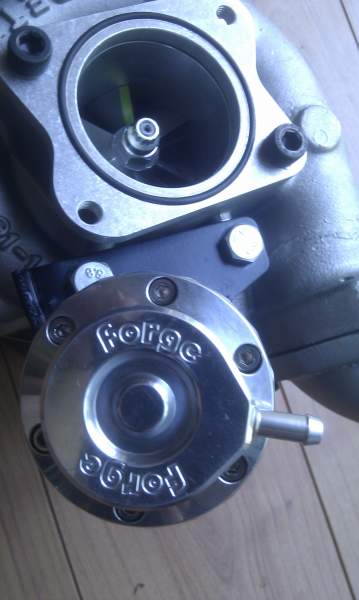

New turbos arrived :-)
These arrived on Friday from CZP, (Garrett GT2871R Ball Bearing Turbo Kit (800HP) .86 A/R w/ Forge Actuators,) plus lots of other goodies.
