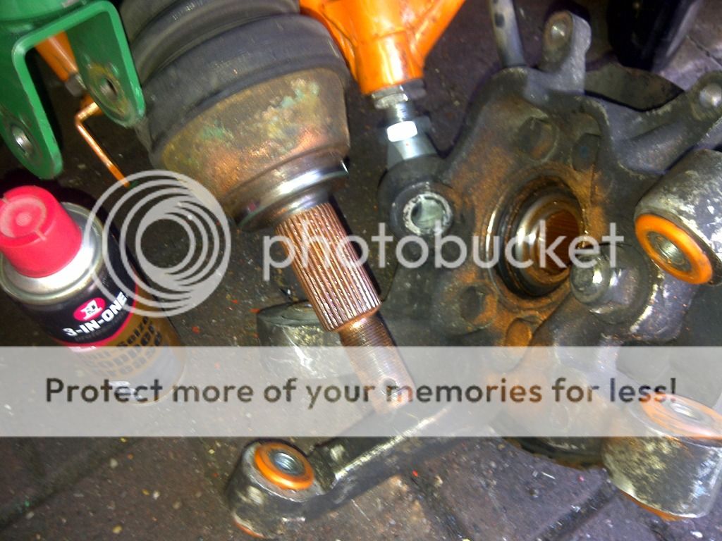

Ok well the hub came off without any problems. I've cleaned it all out (it was pretty clean anyway) and have found that on the hub itself (inside face of the bearing) there is a small rubber washer/grommet with a groove in it. There seems to be an issue with sliding the hub back on so that it's sitting flush; there's about a 2mm-3mm gap at the back.
I've given it a quick squirt of copper grease to help it on its way
I assume that the outer groove on the driveshaft is supposed to sit inside the groove of the rubber washer/grommet but no matter how much tapping with a mallot or tightening of the nut, the gap is still there and the hub doesn't sit all the way back....any suggestions?
any ideas?
Basically, I can slide the hub onto the driveshaft relatively easily and push it back until it comes to a stop.

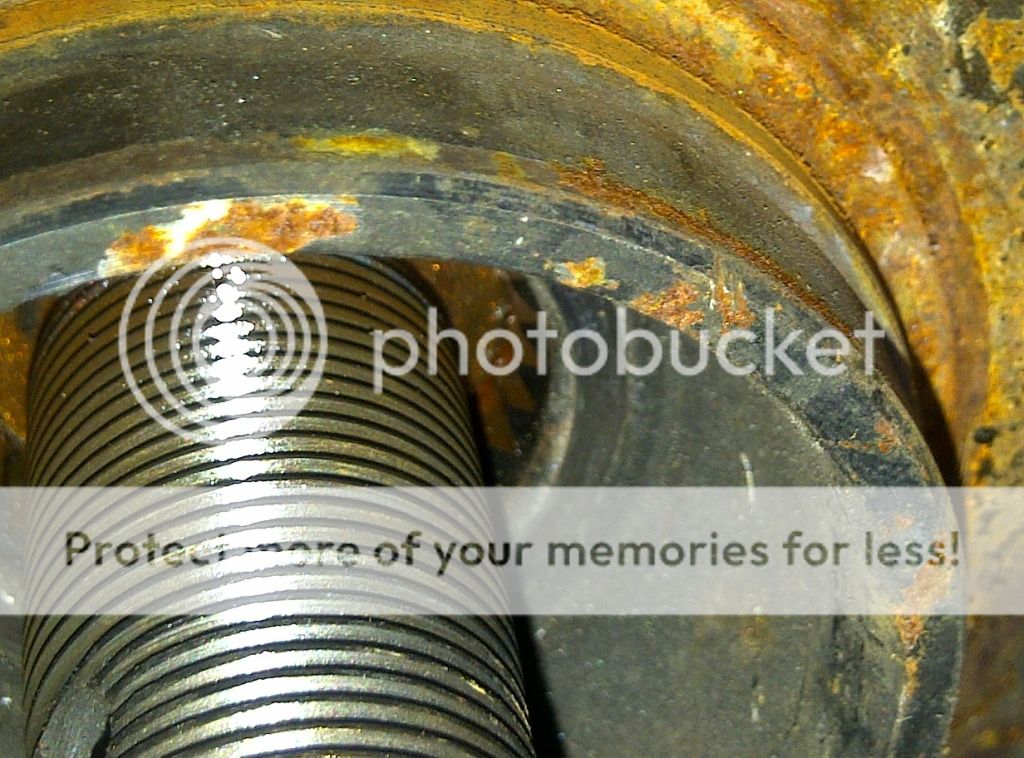

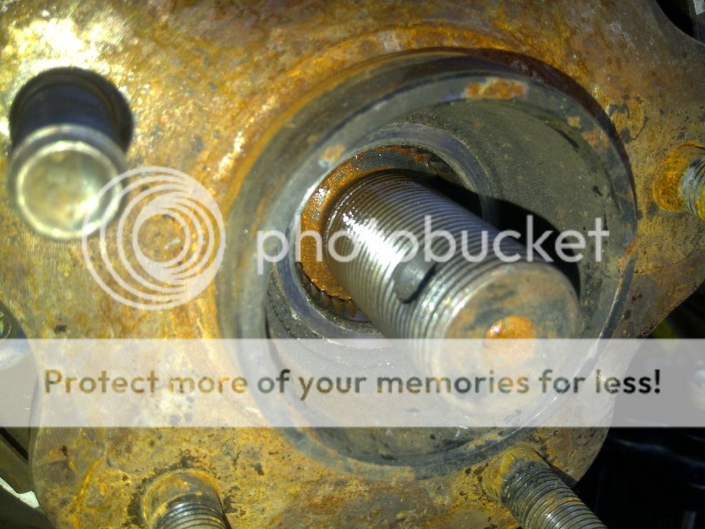

At the stop point, it looks like this:
and when I look at the rear of the hub, there's a small gap
the strange thing is the opposite side (at the rear) has the same gap but that one wasn't removed and there's no play in that one at all.

That's your hub grease seal. I would pull it out and replace with a new one. They need to be drifted in.
