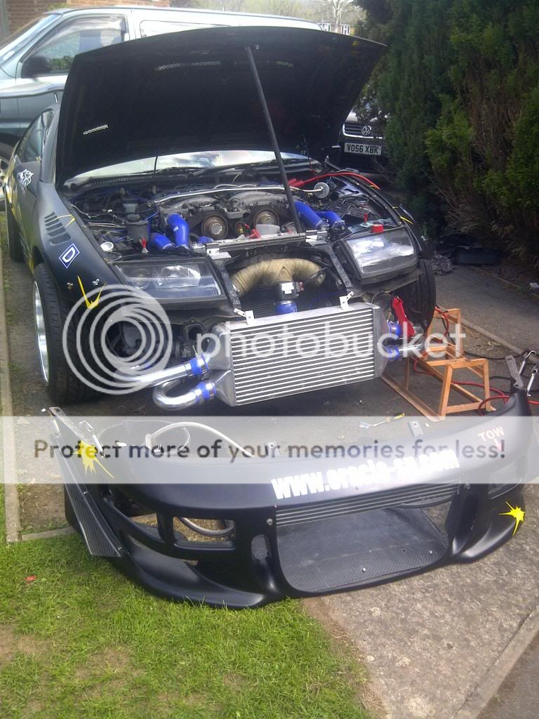

After spending most of the morning making absolutely no progress at all with regards to the VG's running issue I figured I'd take a time out and make a new centre panel. The new panel should (a) fill the gap and (b) give me a place to fit the internal battery cut off switch. The air con is long gone but I thought that a perforated panel would make a good alternative to a solid panel as I could still benefit from the cold/hot air blowing through it from the heater.
It's not quite finished yet, I'm in two minds as to whether I should paint it or leave it as it is. It's galvanised so shouldn't rust and apart from fixing in place with a couple of allen bolts and maybe fitting a short strip of rubber edging along the bottom to tidy it up it's pretty much there.
the running issue has got me well and truly stumped though and I reckon it may be due to a cracked manifold on the passenger side.....we'll see
what is your front bumper m8 and those bits on the side did you add them on? im more interested in the front bumper rather than the side'eeze, lol
Hello chief, the bumper is a urethane GTZ-R that I imported from Stillen about 6 years ago. I've modified it and made the front opening higher and lower openings shallower to accomodate the Greddy 3 row fmic and long Arc oil cooler, the side canards are home made/modified jobbies' made from carbon fibre
