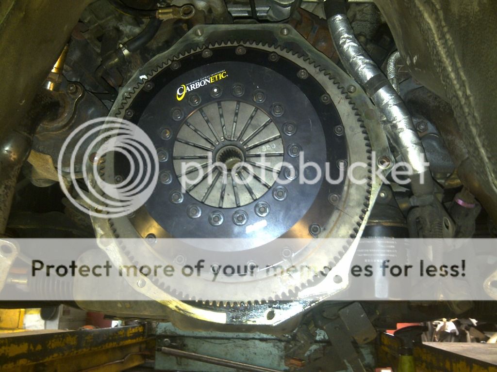

Carbonetic triple plate clutch + flywheel

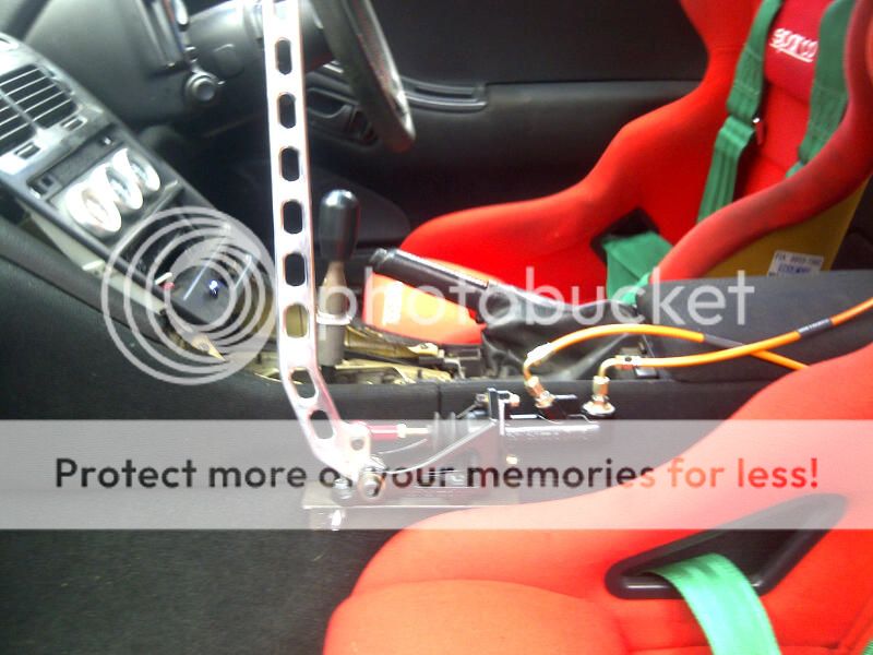

ASD hydraulic handbrake + Willwood brake cylinder/pass through kit

ASD hydro imported from the US, I opted for this as it's the same one that 'D-Mac' (Darren Mcnamarra) is running in Formula Drift
The clutch swap was long over due thanks to a few motorway/duel carriageway encounters that effectively killed my old one

Reckon your hydro is too far away tho and you'll just end up bending it 'cos of the angle. It's always easier pulling it towards your body rather than inline with the cars x axis. Mine goes in a similiar place but on drivers side of the tunnel. It's not as big as yours ;P and sits nicely between gearstick and steering wheel for easy 'panic wanding'! lol

Christ that's one evil looking zed, those carbonetic clutches are the nuts, the only clutch I've ever bought to come with instructions on how to launch the car!!! Lol
