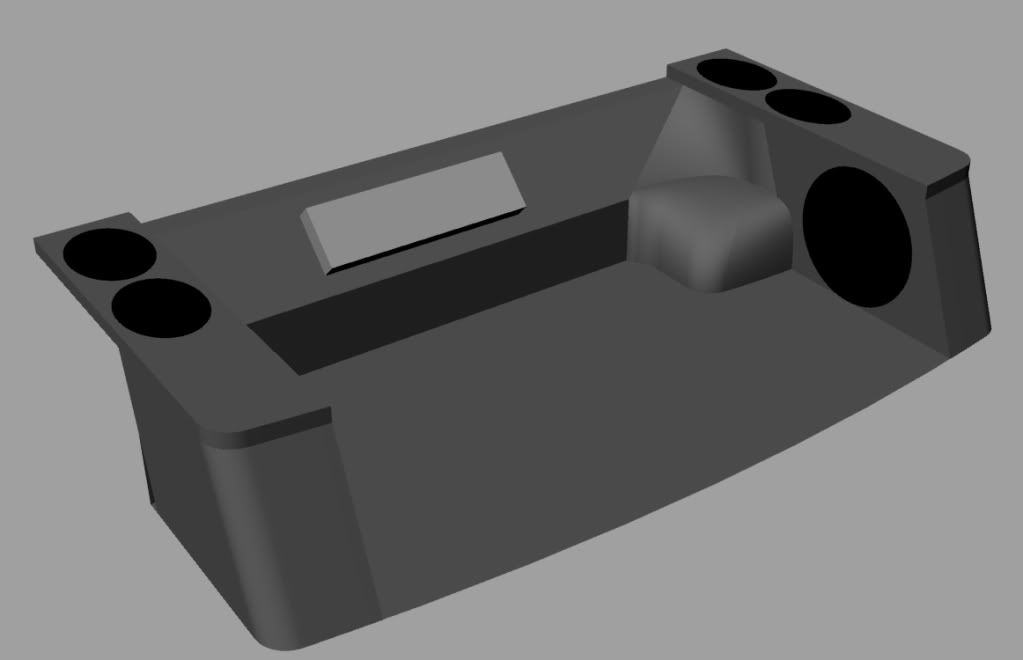

been toying with the idea of making an install, purely because i've never had one before, (not ever had a sub before either...:blush:)
what does anyone think? i still want room for my targa roofs,

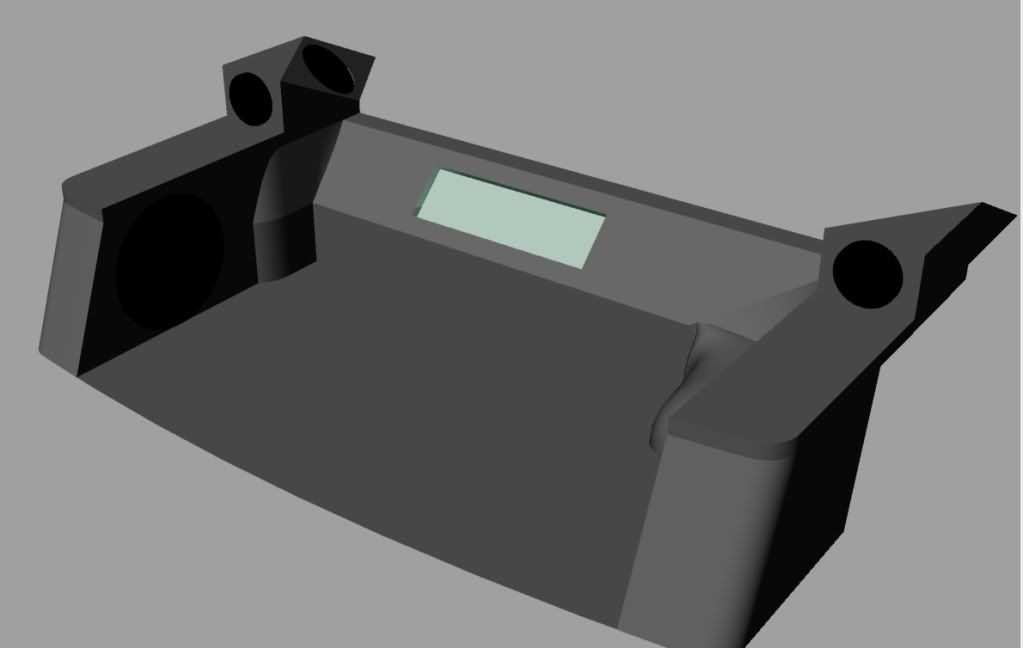

thanks for the info just bought a pair of 10" mutant subs, (picture is a scale model of the boot, spent ages measuring) with the space below where the jack etc are should give enough of a box with these subs.
haven't decided on if i should use more then 1 set of 6x9's in the top yet, or if i should mount anything in the panel with the amp. (not alot f room due to a stut brace.)
if you want sound from the back try not to face any vocal speakers towards the rear window
use one pair of decent 6x9's and have them angled to the cab ...
if its for show ... then by all means get a smaller set of speakers beside the amp ..
but make sure your 5ch amp if your using that ... that it goes down to 2ohms on Main speakers plus Sub

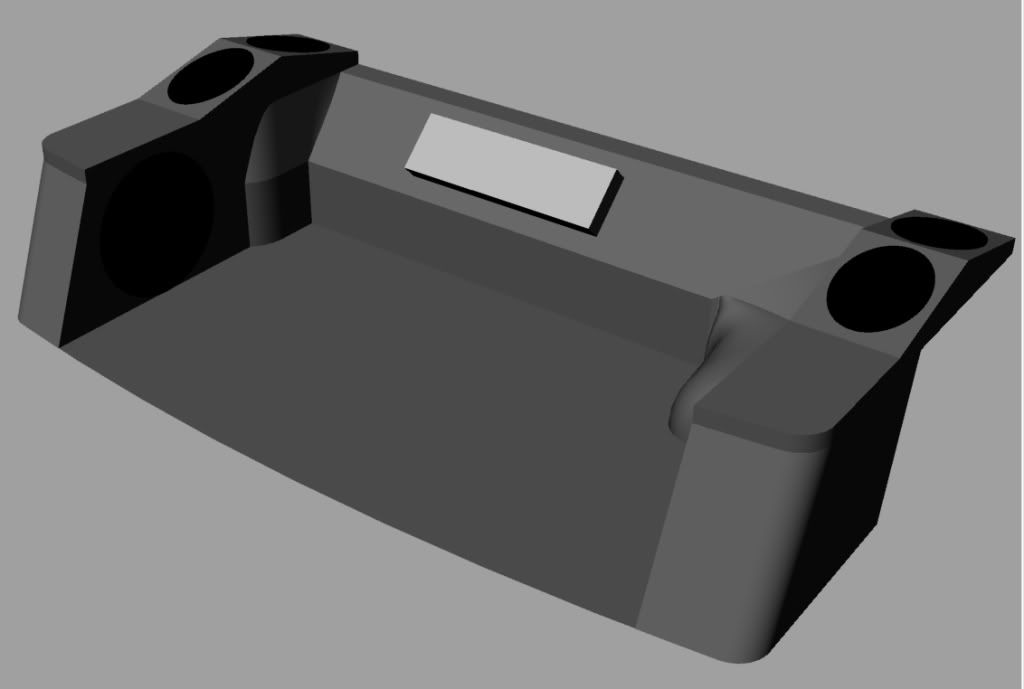

thanks ill play with the design maybe a 45 degree angle on a single set of 6x9s, would point them into the cab better,
i have 4 good tri-axle 6x9s just wanted to use them...

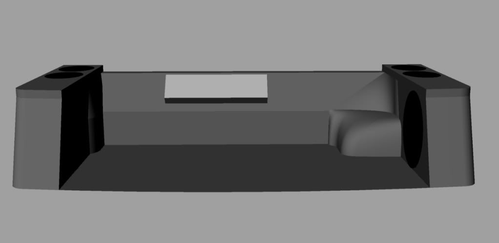

what about this?
im getting a 5ch mutant Ascension amp, 4 x 125W RMS 2 Ohms Stereo + 1 x 325W

the speakers facing the boot lid will be hidden all most by the boot lid surround ... but should be ok due to angling them you will have some Projected in to the cab
the other 2 u will not hear nothing from them inside but will sound good with boot lid open
oh and bring the Amp board forward by 4" about level with the spare wheel and then u can pop the amp behind it and have hole/perspex to show it

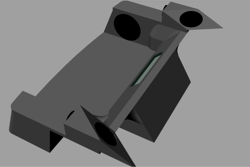

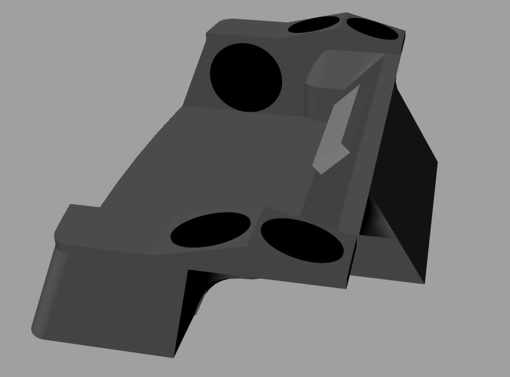

had another go, re measured and their is enough clearance to recess the amp (the amp im getting is fairly thin, ) but not to bring it forward as it makes it to tight for the targa roofs.
angled the rear 6x9's in as well as forward,
