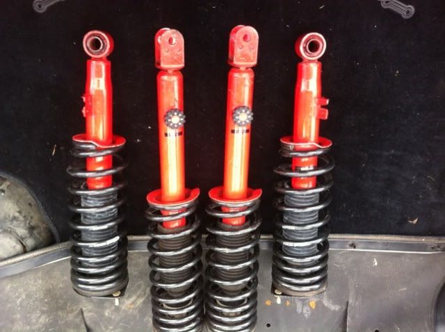

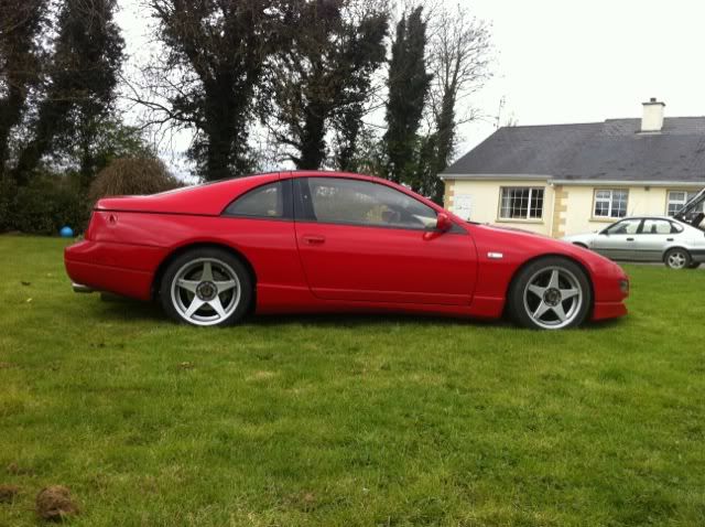

done a few jobs this week,put in a set of kyb adjustable shocks with eiback lowering springs,it made a masive difference to the way car handles and still nice ride on bumpy road.i measured ride height with old suspension then again with new "lower"suspension,turns out car was lower with old shocks and springs,must a bein well fooked!photo-79.jpg also fixed up exhaust,it was blowing where it connects to turbo elbows,so got a de cat pipe and nissan oem exhaust steel o ring gaskets to cure the problem, sounds great-that bubbling sound gone so v happy! photo-66.jpg
