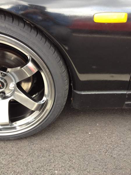

WAS LOOKING COOL! heres a pic!

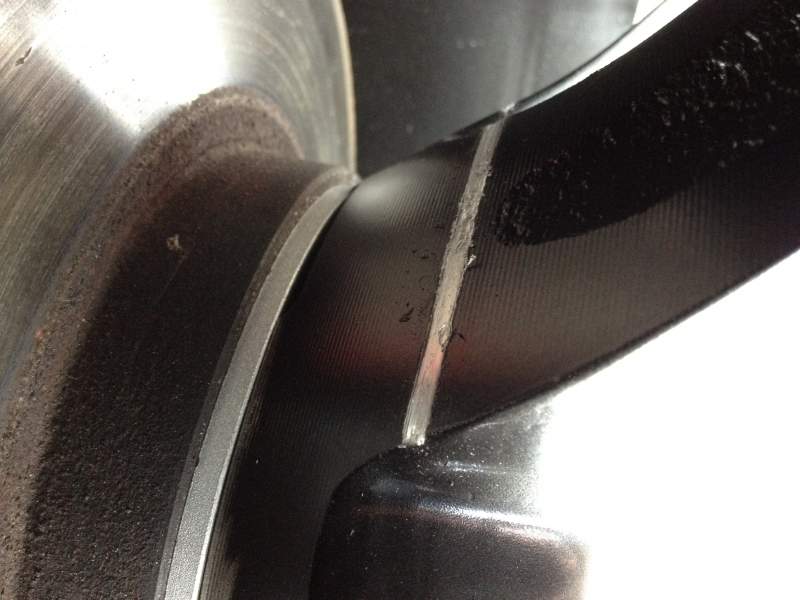

i went round the corner and i hear a grinding noise, im saying wat the **** was that !!!
its the wheel grinding on the caliper lol so im like ffs new ****ing wheels lol ("THANK GOD IT WAS IN THE INSIDE")
So i go and get 5mm spacers for the front(for an offset of et25 now!) it now looks like this lol
i go around the corner again guess what a 3rd problem, wheel was hitting the arch/fender.

  2. Ouuuuch, if they said 30 was fine and you're running with stock brakes, then they ****ed up and owe you a new wheel (did it do this both sides?). Obviously don't get another 30 and use a spacer, that defeats the point of buying the correct size wheel in the first place.

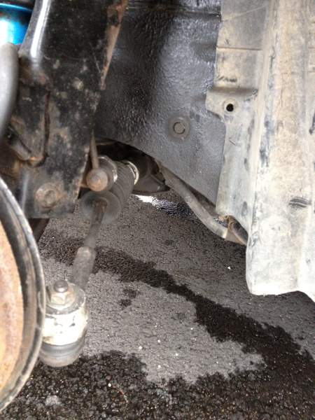

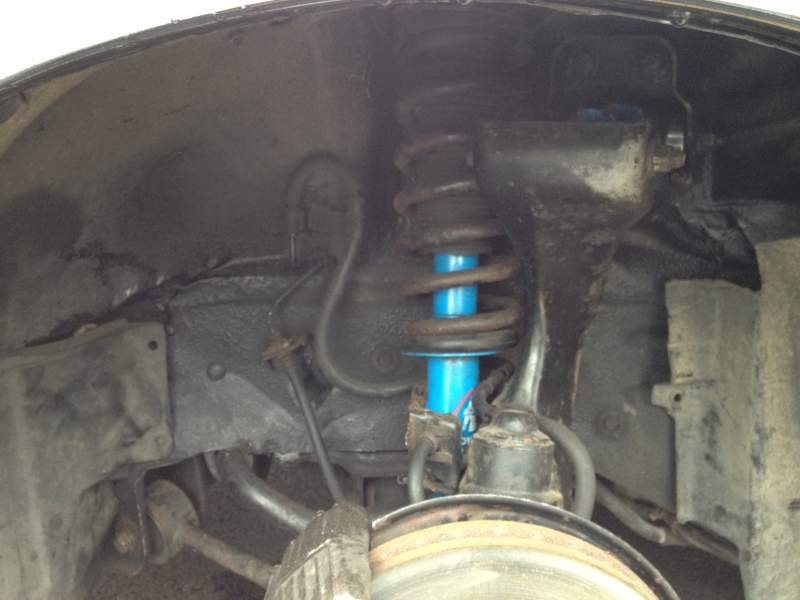

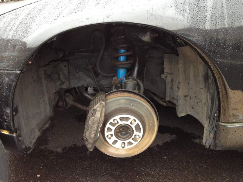

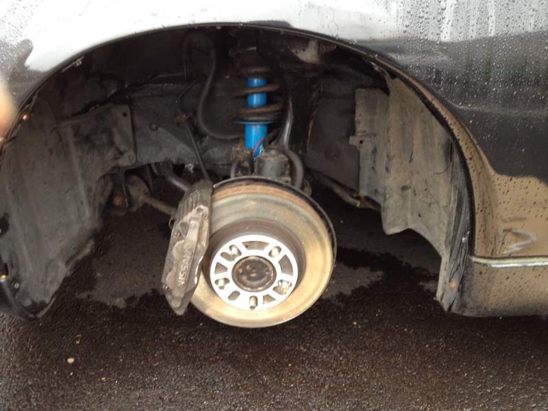

its wet in London to day but still went down a took pics so here they are
oh i was too lazy to take pics of the other side due to there was a car there obstructing me lol
But i definitely think something is bent some where can you spot it? (i wont be able to tell properly till i take it to the ramp tomorrow.)
Spotting what's wrong will be quite difficult, really you need to be in that wheelarch with a measuring tape and comparing gaps and whatnot with the other side to see what is bent/stretched and what isn't.
Also those spacers will lift the spigot ring off the hub, and for Z's having hubcentric fitment, that's no good.

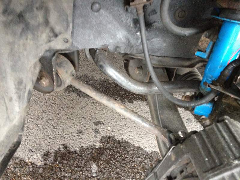

Is it me or in picture 5 does it look like the uptight has broken, from the bottom off the arm up about to about 3 inches above the bolt
Either its rust or your right gonna double check tomorrow didnt see that thanks
Had a closer look at the pic i think your right, it must be con caving/ wadding extra in and out on a left over piece of metal, i know it early but i looked around and its called a suspension knee member if im correct.(I couldn't sleep!)
got tension rods coming today need to find that part as well now !!! :D see if i can get it be for weekend.
Thanks DBnathan
p.s Hope fully there's not another problem!
it wasn't a crack /split ..... it was where it was welded originally.
