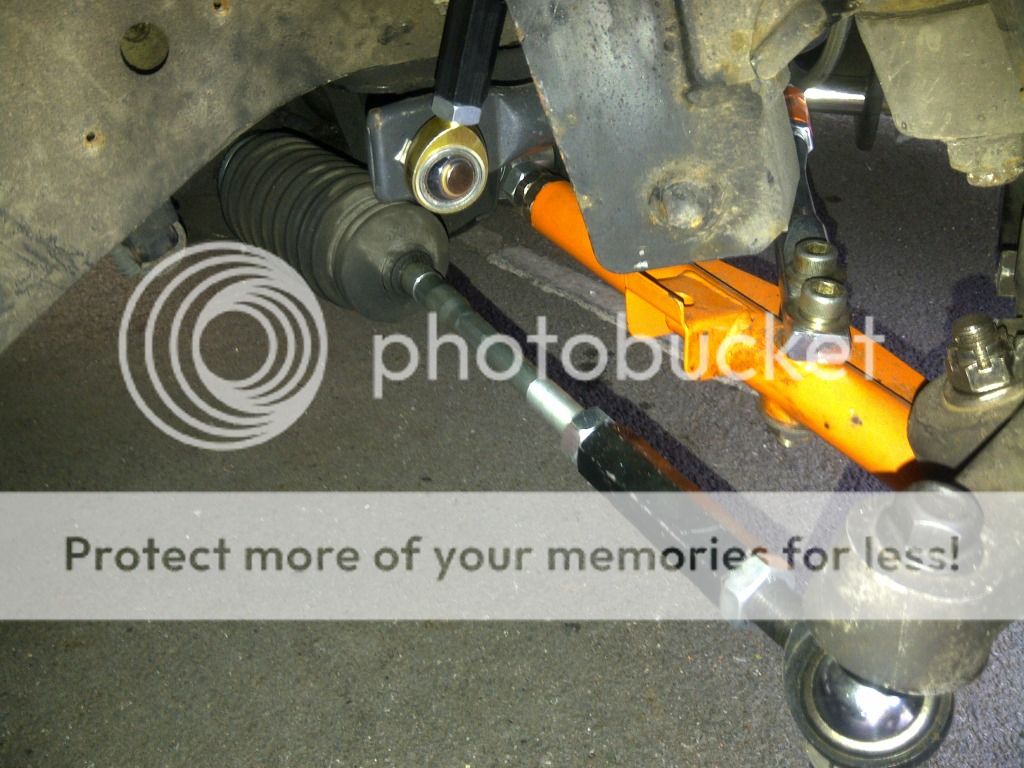

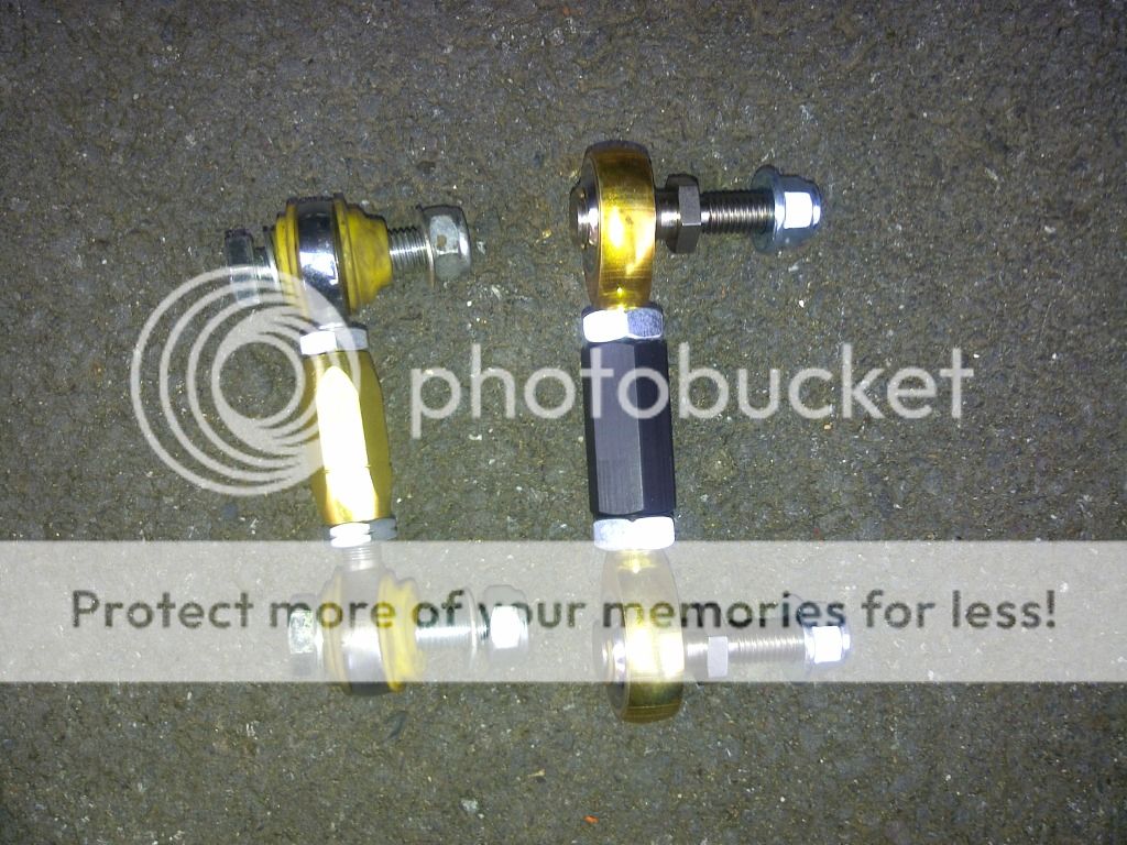

What a pile of shite!
They've been fitted just over a week and both sides have started to rust already!!
apart from the rust the drivers side is fine however the passenger side is ****ed!!!!
now unless Whiteline droplinks fit differently to stock droplinks and require more than 10mm of thread either end then I can't explain why in the space of 15m at a crawling pace, the thread would sheer inside???
incidentally the CZP links on the rear are spot on!!!
any ideas? :blink:

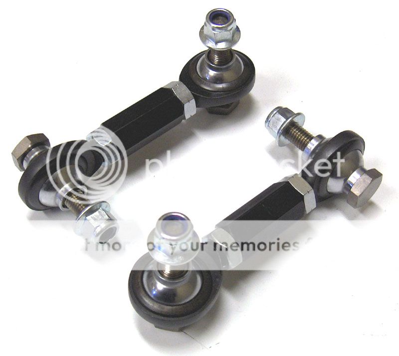

I'm impressed with the quality of the SPL tie rods that I've just fitted and figured that the SPL droplinks would be just as high quality
These are the ones that I've ordered from SPL, they look a lot more substantial than the '****line' ones
Our endlinks feature massive 1/2” bearings to provide the highest load capacity for use with stiffer aftermarket sway bars. High misalignment bearings offer greater misalignment capability (65deg) than stock endlinks to prevent the endlink from binding when used with different adjustment holes on aftermarket sway bars.
Our endlinks are also length adjustable to eliminate preload on the sway bars, which can result from uneven settling of springs or uneven suspension heights from corner weighting.
