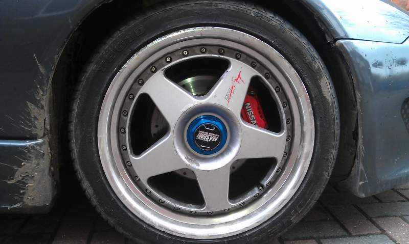

Managed to drop the car off today to get the rims refurbed. For those that missed the last thread, I'd managed to find someone that was willing
to split the rims, powder coat the centre a nice gun metal grey (match the car quite well) and the lip a nice shadow chrome. He gave me a very
pleasing price to the tune of £300, so as you can imagine i was rather excited to drop it off and to allow work to commence.
However, after been back at work a couple of hours i received a phone call telling me its not going to be a easy as once thought, turns out at
sometime in their life, somebody has actually welded the seal around the split, as well as siliconed it. So he says they can not be split.
So i'm left with the choice of either getting them done all in one colour, abandoning them completely and buying a new set, or just living with them as they are.
I've google'd the shit out of them and not for love nor money can i find some new ones. So i'm actually devastated, I love the rims and i'm
sorry to say that if the car didn't have them when i bought it there's a good chance i would of walked away and bought something entirely different.
I have thought about just getting them coated in the chrome, (providing he's willing to remove the bolts first) and then at a later date if i want
to, try and get the centre painted and lacquered in a nice grey, but not sure if that would be do able.
Here's some photo's just for a reference.
Hi Stevie, what you have are 2 piece split rims, you can still take the center out and you are left with the rims intact, so you should still be able to do what you want, tell your man to undo the bolts as normal split rims and push the center out it may need a small amount of heat but it will come out.

Well I spoke to the guy today. and it turns out the spokes have been full blown welded to the outer rim, and aparently its a really nice weld too. So unfortunatly there's no chance of them been split. So i've decided to get them all done in the Shadow chrome, unfortunatly it means the bolts will be powder coated over, but they'll be in better knick than they were.
Depending on the turn out I mite see about getting the spokes sprayed grey and laqured after, shouldn't be too much to mask off the rest. but its still a bit of a bummer about the bolts.

If the rim is made how i think it maybe, then yes its made in 3 pieces, but the front and rear of the rim are joined and welded then sealed the centre is cooled and the rim heated. Then the centre is put into place, rim is then allowed to cool and the centre is then held solid, the bolts are an added strength.

Common practice for Japanese made split rims to have the barrels welded together.
But doesn't it defy the point of been split?
