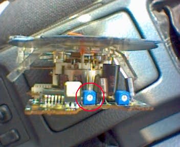

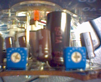

You can also calibrate the speedo by adjusting the potentiometer on the speedo board, you would need to drill a couple of small holes in the top of the plastic dash and use a small flat blade screwdriver to adjust.
Thats how i did my speedo calibration, just a bit of a nightmare driving and adjusting......
Al.

If so is there a pic of the screw I'm supposed to adjust.
Never played with speedo before.
I'm lost lol.
Thats the little puppies............ IIRC, 1 does the deflection at speed and 1 does the rate of deflection from speed..... If that makes sense. The best thing to do is drive and adjust as you go.
Alz.
Oh god that sounds and looks complicated,

Wasn't expecting pics like that thank you.
Hopefully I don't need to use them.
