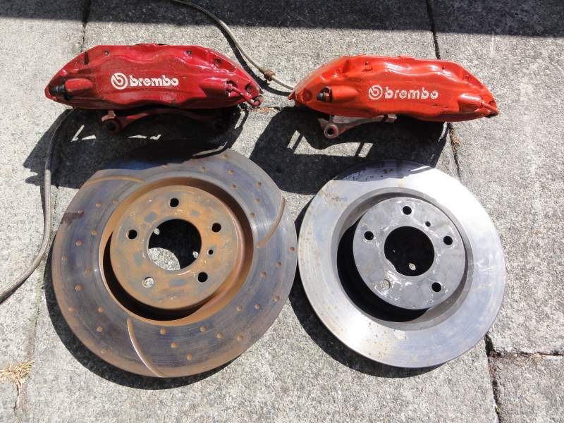

not sure myself, but will measure mine for you when I get back home, here`s a comparison pic if its any help from what you need on the left and stock on the right

Actually scrap that ^^^^^^ I think that picture is of your brakes on the right!!!, will sort it when i get back!!
Yer, thats mine on the right bud.

Sorry for the late reply...i couldn't get an accurate measurement until I have just taken the wheel off...... so the discs you need are 324mm, hope that helps
im running 350z front discs on my evo brembo conversion, they are 323/4 cant quite remember and 32mm thick, you need to make sure you get the discs for the brembo calipers
