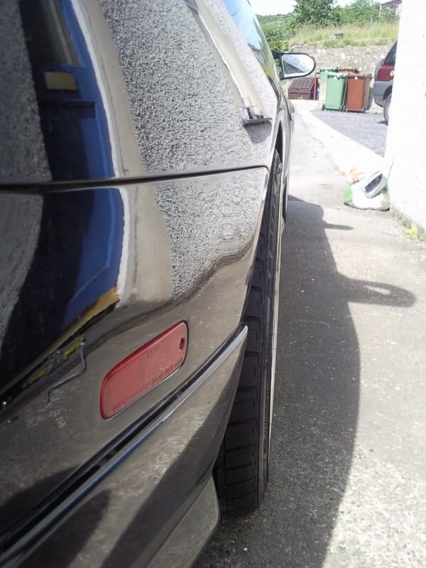

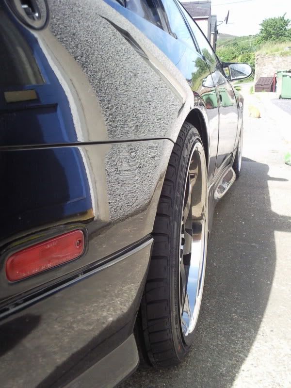

I've opted for 18" x 10" wide CV Pros (one piece rather than split rims) on the rear of my shortie. They sit flush to the rear arch with no requirement for spacers, however pre-empting possible catching issues if I were to use 265/275 tyres, I've now opted for narrower 245/40/18 tyres on the rear and will just adjust tyre pressures as appropriate for grip.
Do you think that rolling the rear arches slightly or going for slightly narrower tyres might help on the rear mate?

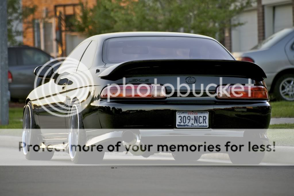

Here's an example of a 245 tyre on a 10" wheel

ive never understood rolling the arches? the fronts catch mainly when the wheels are slightly turned and you hit a bump so need to sort the ride height definately.. I did think about taking the spacers off, but think they will still catch.. I love the wheels and love the stance.. who do I talk to about rolling the arches and what sort of cost would I be looking at?

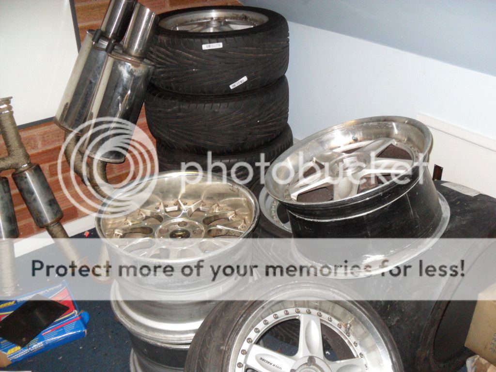

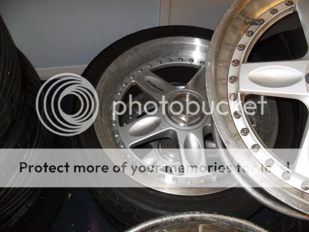

I must have a CV Pro fettish or something, I've bought a load more since I sold the last lot and have them stored above the garage (and this is only half of them!)
If you want to pop over and see if any of these fit better you're welcome to, it might be possible to swap parts over in order to make a better fitting set (ie. change the inner rim etc)???

just for reference this is what a 245 tyre looks like on a 10" wide rim, perfectly fine in my opinion

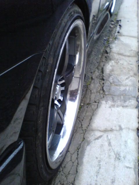

And here is what mine looked like not even touching the rim with a 265 tyre :nono:
if I tried to run a 265 on the rear as it currently stands, with a gap of approx 10mm (arch rolled or not), there's a good chance that the edge of the tyre would catch the arch lip everytime it went over a speed bump
10" rim with an offset of +45 = rim lip sitting a few mm outside of the arch hence slightly narrower 245 tyre in order to be legal
