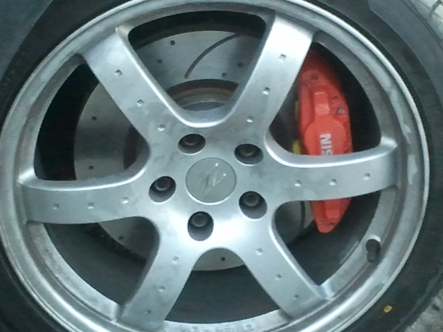

Evening folks, today I fitted 350z Track discs with caliper relocation brackets and 300zx calipers.The discs have been skimmed, but the brake pedal pulsates when braking and the car shakes if braking from any sort of speed.Can the discs being the wrong way round (check out the grooves in the photo, drivers side) cause this, or could it be a sticking caliper?.Braking was fine with old setup by the way.
Going to get a dial gauge on them tomorrow, just thought someone might have an idea if the discs are 'handed', left and right.

would say they are warped or not been skimmed true make sure the facia of the hub and rear of the disc is clean
as for the grooves direction its dosnt matter just will make a little more sound when hard braking
Years ago, I had a pair of very slightly warped discs skimmed, when they were refitted, the pulse changed to a violent shake at any speed above 10mph, discs were not skimmed straight and true. I'd check with gauge for confirmation, though you will possible see it with the eye if it's bad enough.

Checked the discs with a dti this morning and they were warped so got them reskimmed and they are now perfect.just got to do some steady miles now to bed the pads in.Also took the opportunity to repaint all the calipers so it all looks spot-on :)
