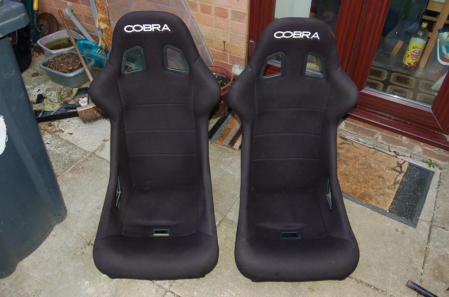

I have a pair of bucket seats chucked in the back of the garage, and also a pair of manual Z32 front seats. I really like the leather seats but I dont mind having some lightweight interior that I can throw in when I want to be dragging round less weight.... :wink:
So here's the seats:

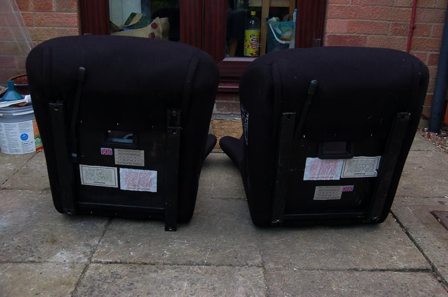

and heres the bottom of them, already got 'some' rails fitted (not sure what they are from!
Do you think I can fit these seats/rails to the Z32 rails somehow and what would it take to mount them?

Btw those seats look bloody awfull. I hate seats you cannot recline.

and no they dont recline... but I'm not as big as you... :tt2:
keep in mind that if you add your own runners and a non standard mounting arrangement your seats might sit too high which will ruin the driving position.
measure the seat base from the floor and aim for that or lower.

This is going to be a whole lot easier if you have a welder and can weld.....
Because those are lower budget seats that are base mounted rather than side mounted, you may have an issue with overall seat height by simply welding them into the stock rails. Your also not going to be able to alter the amount they recline like a side mounted seat.
It appears they have a set of generic low-height rails fitted as standard, but what your going to have to do is see how the width compares to the stock rails. If the width is good then you can use the rear holes like the stock rear hole mounts, then cut the front legs of the stock rails and weld them on to fit the front.
If the width is wrong, then your looking at knocking up a custom brace to match up the rail to the stock mounting points.
Either way, I would take into account how you want the seat reclined when working out the front mounting points.
