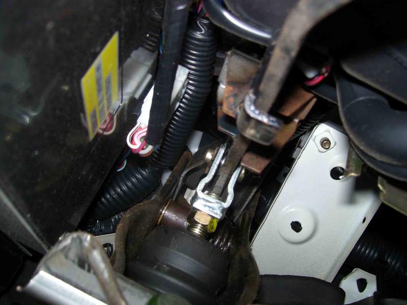

Cheers Guy's,
I will have a look later on today, I will take some pictures if I can get a clear shot.
Another job to be looked at! oh joy.

It was bad enough just getting the photo let alone working under there.
That said, Am I looking at the pin in question or will it be the pivot point? God knows where that is!
Took some dash panels off and managed to press the pedal while at the same time feeling for any movement.
Yes, there is about a 1/4" of pedal movement due to possible egging as you say Pablito,
but the majority of the movement can be felt at the threaded coupling with regards to shaft moving into the rubber gaiter quite a bit before meeting any Resistance.
