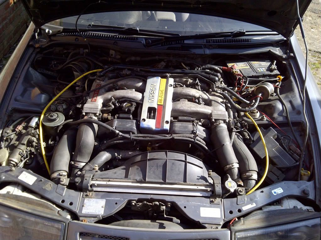

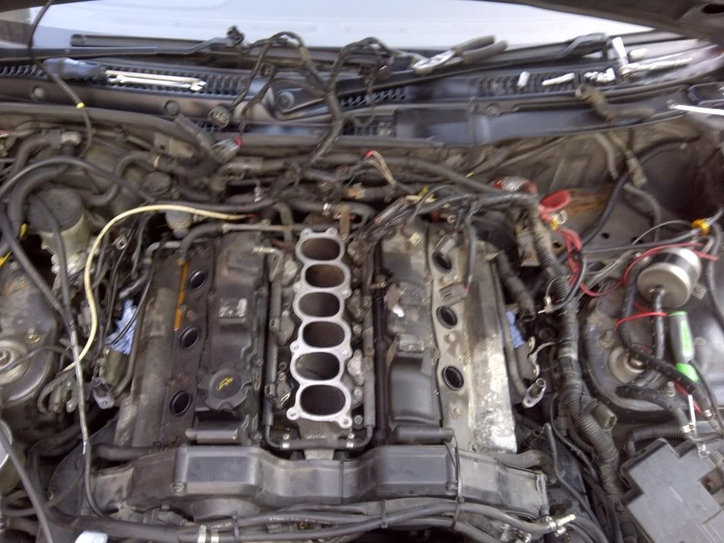

mmm i havent subscribed yet lol.. otherwise id have deleted the horrible attempt to add some pics. sawwy. ive taken the plenum off took me two hours, but happys hours :D
on
http://i1049.photobucket.com/albums/s392/darkduffer/IMG-20120328-00128.jpg
off
http://i1049.photobucket.com/albums/s392/darkduffer/IMG-20120328-00136.jpg
now im not sure but i feel that the egr may have been already bypasssed? :detective:

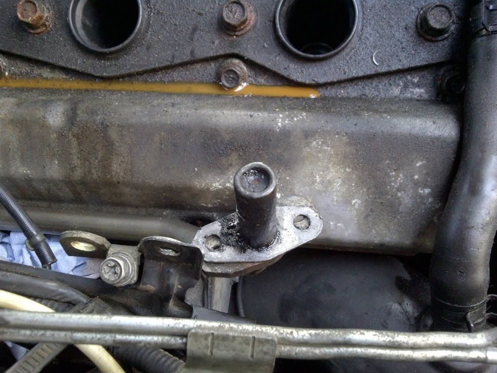

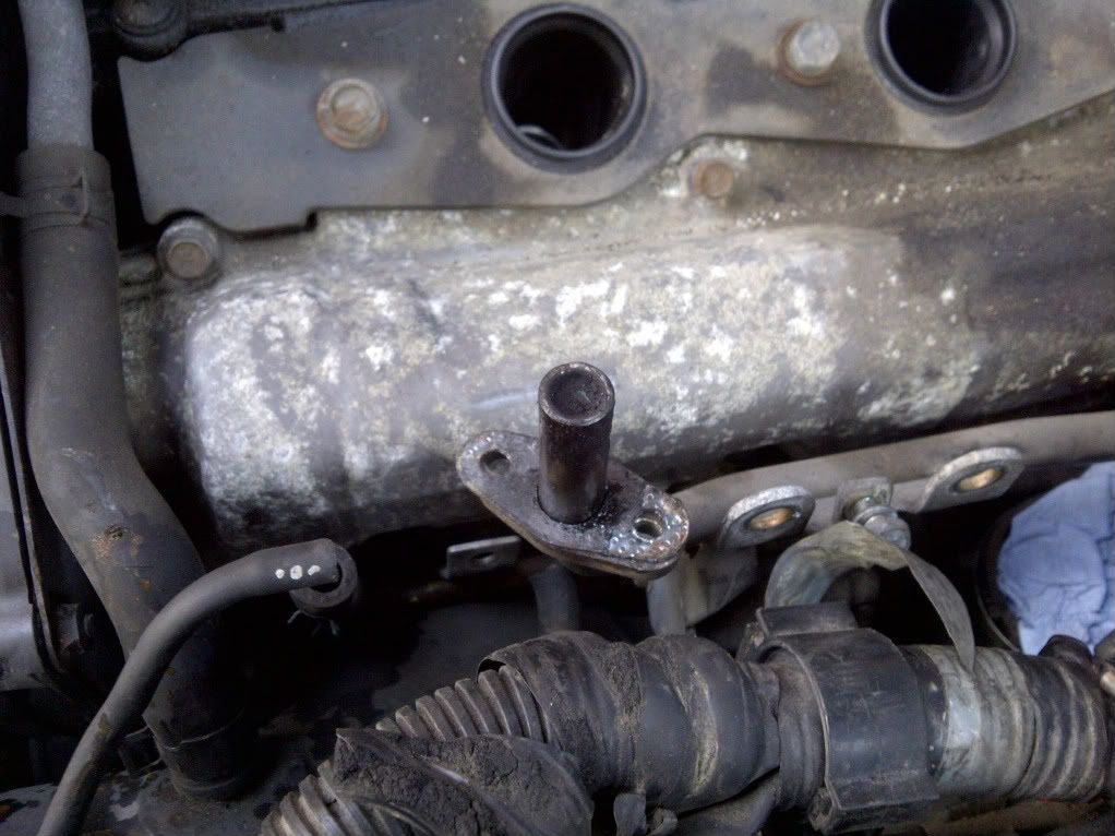

the egr connectors that connect to the front bottom of plenum seem to be either clogged!? or blocked? :confused1: didnt really check as i was excited i managed to remove the plenum and to take pics to share.

im not sure as this is my first time doing this and the yellow pipes are? :helpsmilie:
egr is still in place btw.
i call upon thou for guidance and help!!
From memory, I think that's how they are. In other words I think your egr is st
ill operational. Best if someone else can confirm this, my memory isn't the best these days!
Checked an old photo, mine was the same. You can stop it working by disconnecting the solenoid, but I think completely removing it is difficult with just three plenum off.
very much so .... getting the EGR off isn't so bad its the pipe that goes to the Passenger side exhaust manifold its a pain and Rusted well ...
best thing to do is block the holes in the pipes to plenum and disconnect the vac line to the egr
