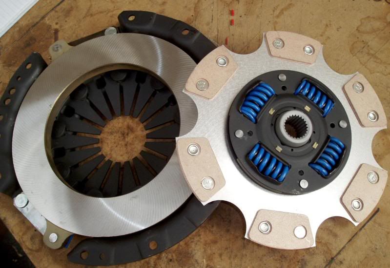

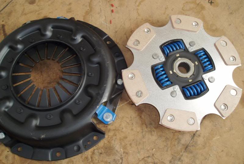

Non turbo clutch units such as the ones below are easy on the the leg and good for any power mods, in fact we use these for where a non turbo box is used in a TT zed.
Jeff TT
how much are these Jeff please.? i'll be needing one soon cos i have tt with full na set up. i love the feel of the clutch.plus what horsepower can it cope with?
