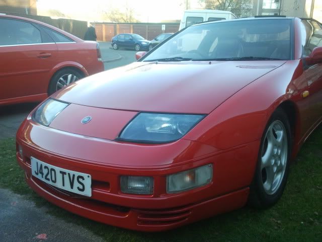

my new red zed thread ;) (project)
Thought i wud start a project thread
to be honest iv been a little daunted by a few mechanical jobs needing doing so i put it on ebay out of haste !!
but decided today am gona crack on and do it :)
heres a few wen she arrived
Abit of buffing
Black roof bars and trims painted
Edited by kenztwinturbo

needs a hicas pipe or lock out kit , a downpipe and joints need sorting on rear boxes ! and a weld to the front florpan wer it meets the cill !!

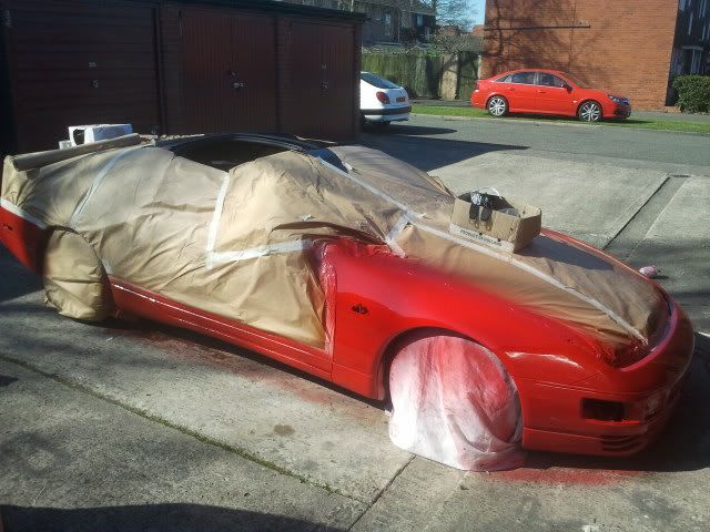

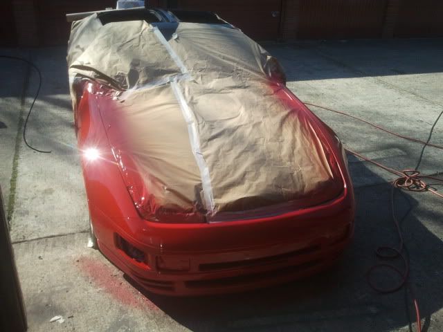

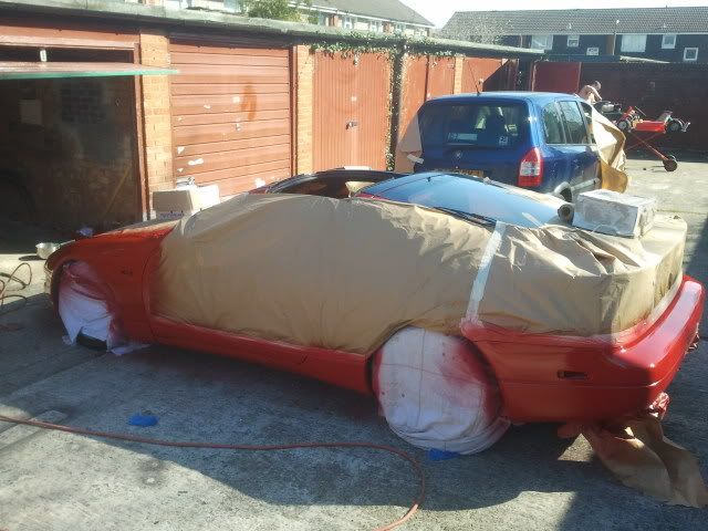

Ken, out of interest, what spray equipment (if any) did you use and what paints/lacquer's etc (i see a pipe so i guess its from a compressor)
(for the techie geeks out here...)
Rich
No probs pal , i only use 2k (2pak) paints this was clear over basecoat . and i would normally use an oven for a big job ! however if you know what your doing u can get away with spraying outside it will.just require more flatting and buffing !
my compressor is 2.5hp and eases jobs like this and with experiance u learn wer to let the comppressor run out of puff and let it build up air and have a dry patch (polishable later)!! for example ... my comp wud not have coped well if i was going to paint the door and wing together as you cant really stop half way through a panel !!
my gun id devillbiss gti pro !
so sorry its difficult to explain this painting lark lol theres more to it than people wud think and all painters have there own ways and ideas i suppose !
