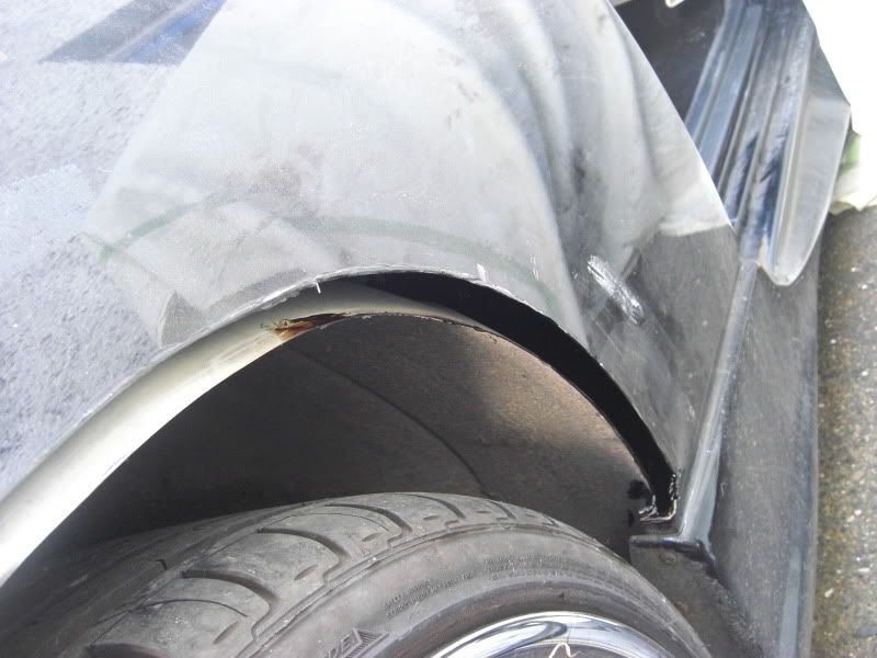

I have now cut away my rear arches and now i have big holes. The rear arches were starting to blister so i thought oh ohhhhh here we go all the sills will be on the way out.

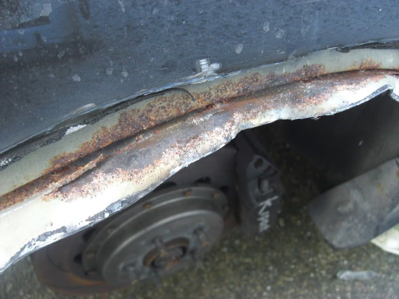

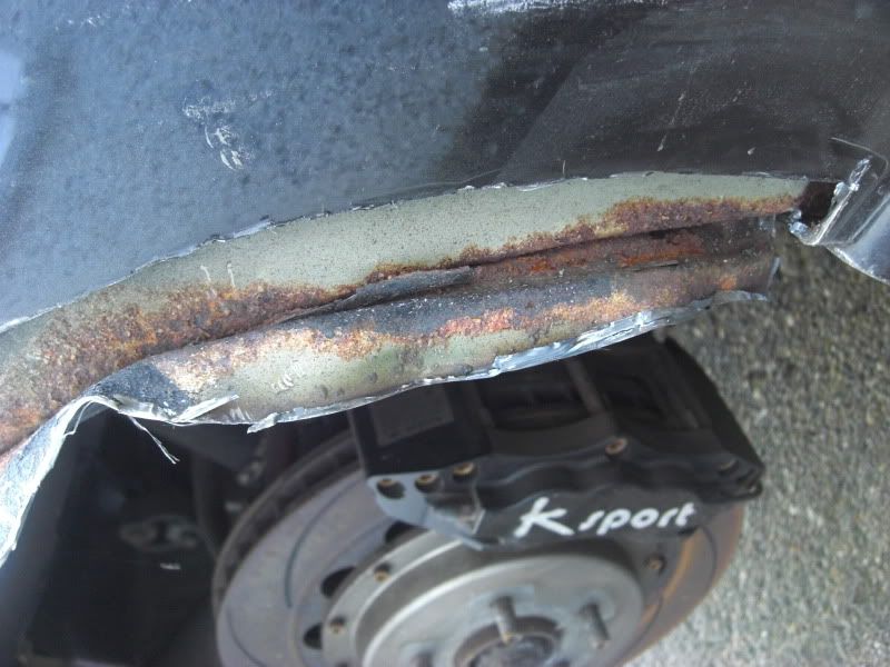

So i cut upto the curve in the metal to allow for my wheels and fatter tyres to be spaced for the new wide arches. I was surprised how little rust there was. It was pritty much just on the lip. So i got my Lamp to have a look down and all around the sills.

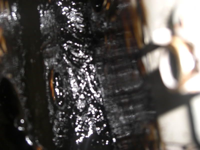

So i got my spray waxoyl and did both sides. its proper gunked up in there now and not a single bit of bare metal anywhere. I have also got the brush on stuff which is really thick. got it in my hand and spred it from the inside all around the drain points. and forced it into all the folds and welds So my car should now pritty much live forever.

Its a shame that the lip/fold rusted. the bubbles came threw about 2 weeks after my spray job typical for me :( as the car would of been finished but it will come back bigger and better.
Im amazed how everthing else looked new :dance:

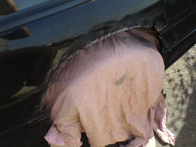

Cut along the line so it gave me about an 1" gap and hammered it down to save me going under the car to grind.
Then i tidied up the line ready for my mate to weld it up

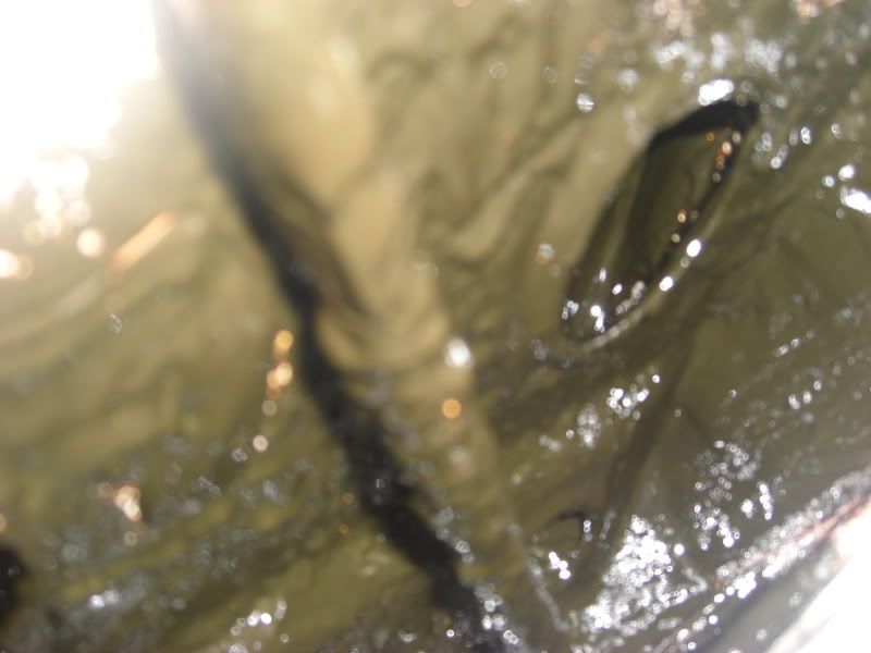

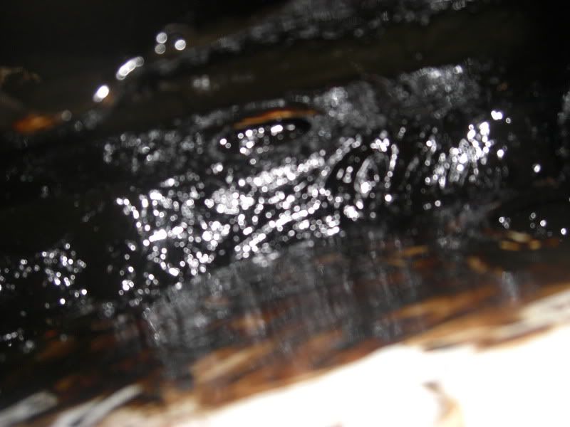

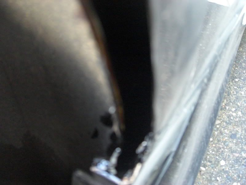

Then just pumped waxoyl everywhere, I took these with my hand inside the sill. you can see the Tbar pipe.
Thats it for now. Once the hole is welded up i will then get inside and give everything another coat :)
not much at all. just on the lip but the arches were seriously stating to bubble, No rust there now :cool3:

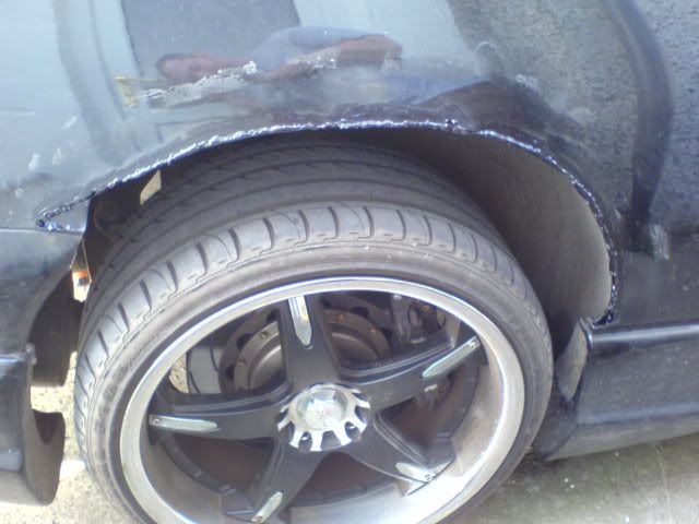

Tidying up the weld with a sanding disc on a grinder

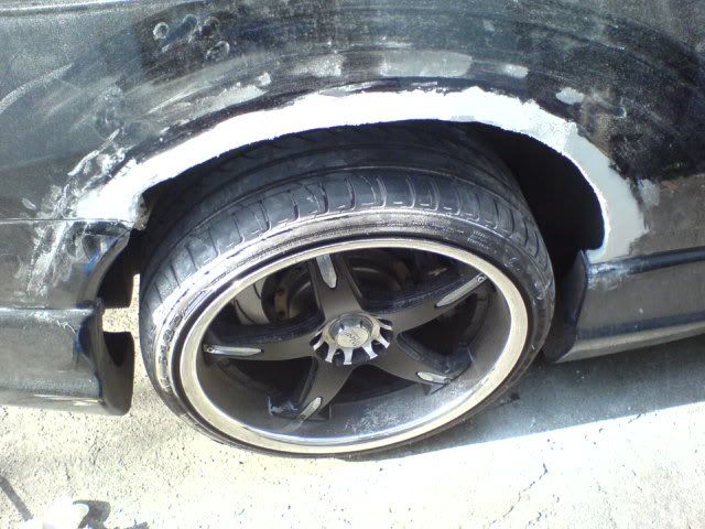

The sealed the weld with cure rust
Used plenty of filler to smooth the welds and get a nice inner edge, not finished just a quick snap

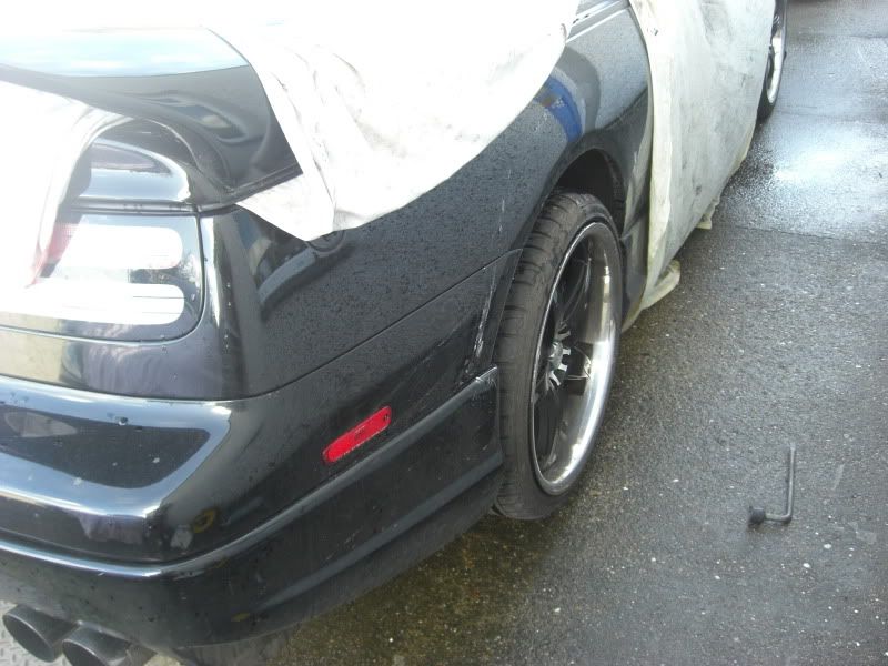

Its all been undersealed now but i didnt get a pic? Think abby started crying. will grab one tomorrow
