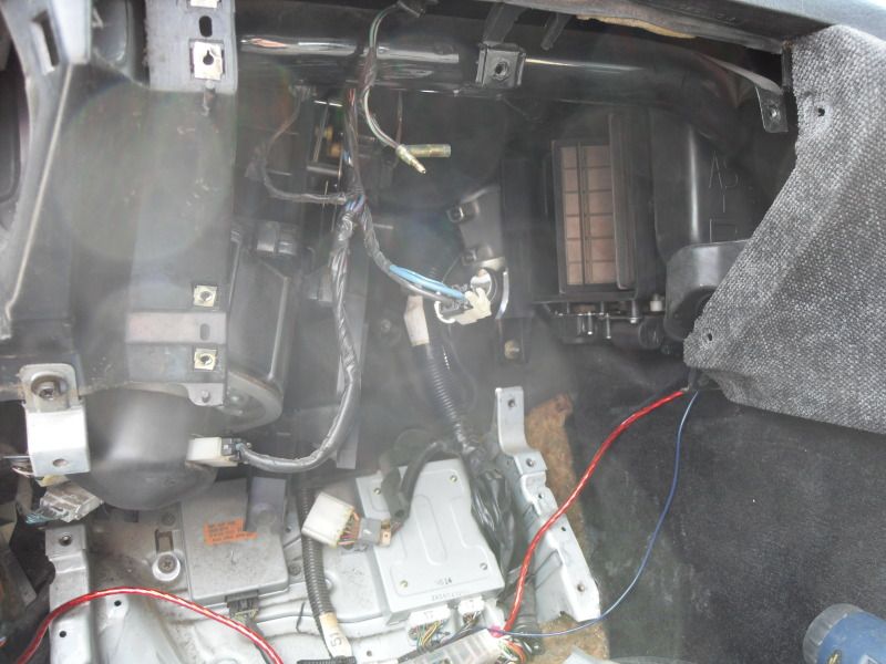

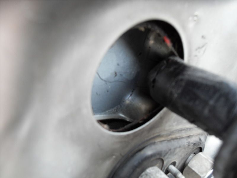

Here you go bud a few pics from when i did mine , just as Tudor mentioned , if you pull the wiring grommet out of the bulkhead you can see the bracket that clamps the loom to the inside of the bulkhead

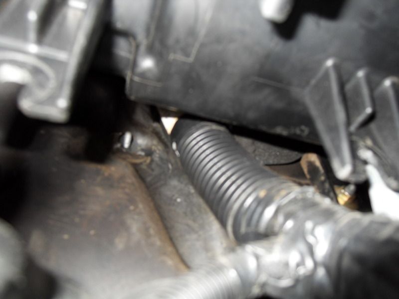

Looking up under the dash you can see the loom but can,t get to the bracket to release it

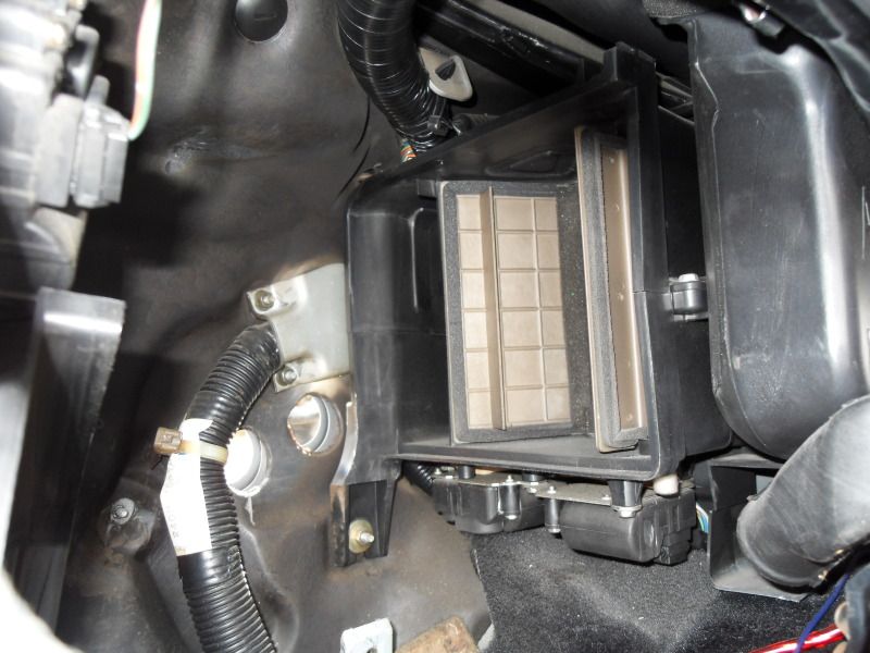

Remove the glovebox and the section of the aircon system behind it to give access to the bracket , that,ll give you all the access needed to fit the new loom through the bulkhead .

Doing this job now but the air con box doesn't want to come out. I've removed the bolts along the bottom but seems to be stuck top right hand side. Is there a hidden bolt or do I just need to tug it a bit more
Not sure Rob we have not started yet but I guess the others may know why this is.
Dave
Found the problem mate. There is 2 air con pipes that run through the bulkhead into the box. These need to be undone and hopefully the box should come out.
