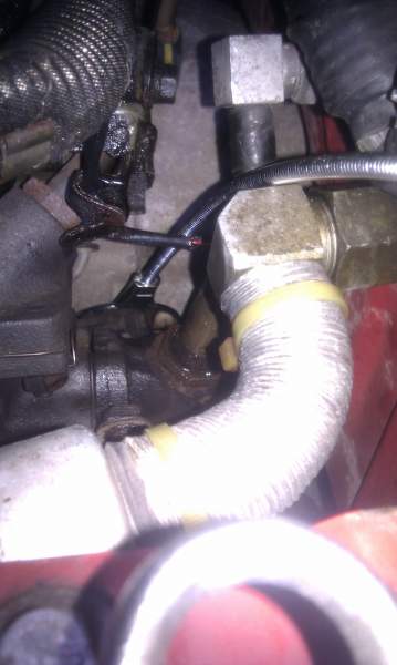

Ok, got 3 out of the 4 nuts & bolts off the passenger side. Still have the top studs drivers side to do, which seem to have less access
The one stud I'm having problems with is the lower stud, nearest the transmission tunnel. In the picture you can just make it out next to the mirror. Do i need to remove the O2 sensor to get better access? If so is there a special tool for removing it as I think it's a 22mm nut on the one thats higher up. If I need to get the sensor out should it come out easier than the bolts/nuts? btw is the large silver hose the wiring loom or something else?

yes removing the sensor will give u better clearance for that top right bolt
but be careful as the sensor hex are not the best make sure you use the correct and decent spanner
cheers Mark, looks like I'll be buying some larger spanners then, lol
is that silver hose the outer sleeve of the wiring loom?
no its a heat shield for the oil pipe if your referring to the one in your pic in the middle
and the one to the upper left pic think is the egr pipe with shield
its quite hard to remember what the parts look like with just a small pic
sorry edit that you taken the pic above from batt tray place ..
its the Main AC pipe that goes through the bulk head
yes picture was taken form battery tray place, if it's the AC I'll leave it alone, thanks
