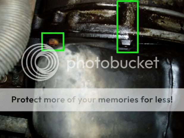

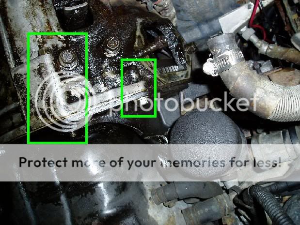

Found these pics here
http://i863.photobucket.com/albums/ab199/rautoshop/300zx/z127.jpg
http://i863.photobucket.com/albums/ab199/rautoshop/300zx/z128.jpg
first pic bolts look to be the Turbo Core bolts not the downpipes ...
edit thay look like gearbox bolts too
2nd pic is the backet brace for the gearbox .. Not those Bolts ..
on the turbo downpipes .. that your trying to take off will have 2 nuts and 2 bolts per turbo ..
these are on the down pipes them self ..
u can undo two from the bottem and 2 from the top ( per Turbo )
to get to the Top Bolts u need to take off the Black Turbo Pipes from either side of the engine
