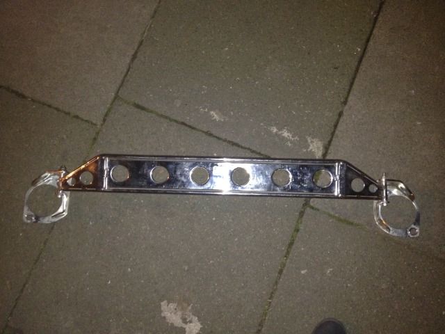

I am been looking to buy front strut bar for ages and now finally I got one. Does anyone knows what differences does it make in handling ? I been driving s13 with strut bar and with out and is huge differences
