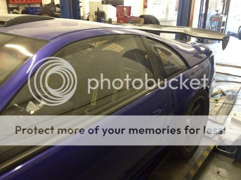

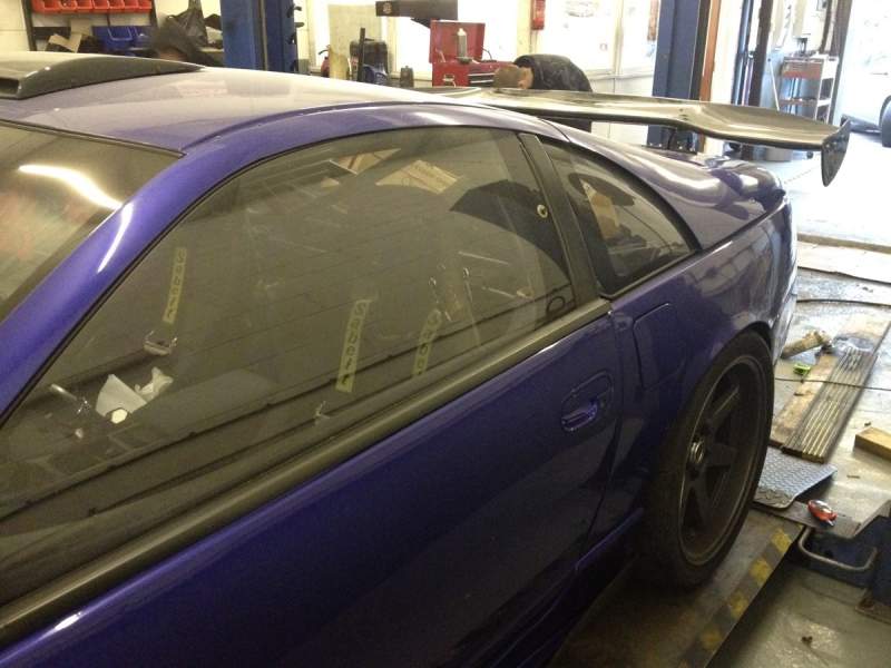

Hi dont know if you have ordered these or not yet but mine are 9.5J all round et30 on the front and I think et35 (can't remeber) on the rear. I have 225/40/18 front and 245/40/18 rear. My rear arch's have been rolled and i dont get any rubbing at all. my fronts are rota gtr's mind not the gtr-d
couple of pics
