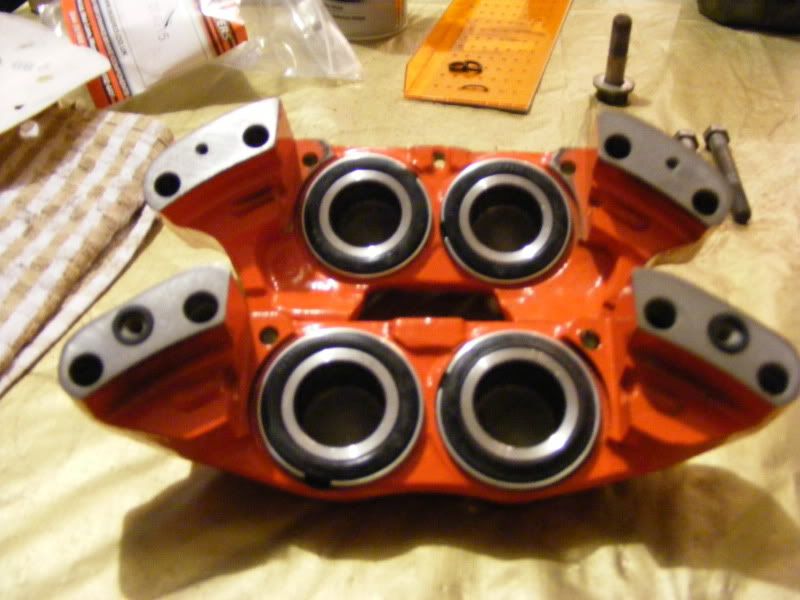

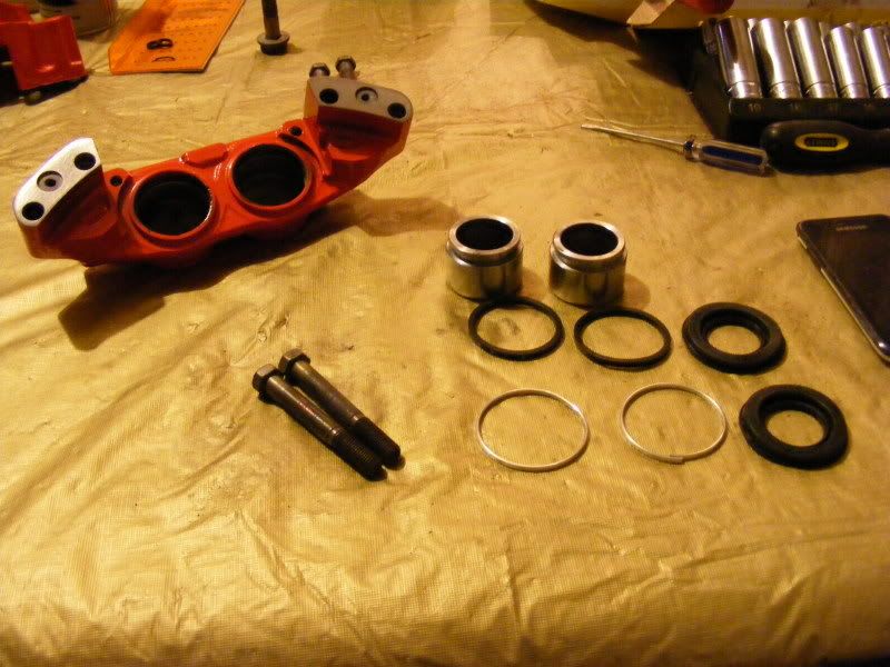

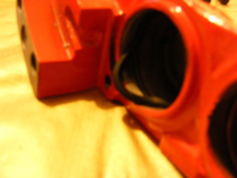

Well I finally got round to getting my spare set of front calipers rebuilt and all back together. I striped them down monday and sent them off to be shot blasted and powder coated. I bought 8 new pistons from godspeed and a new seal kit from fleabay (biggred) and done as follows.
Insert new seal in the chamber

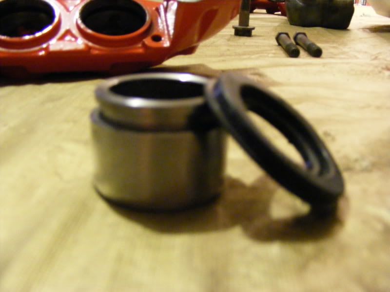

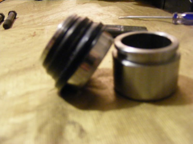

Then I put the new piston seals onto the new pistons

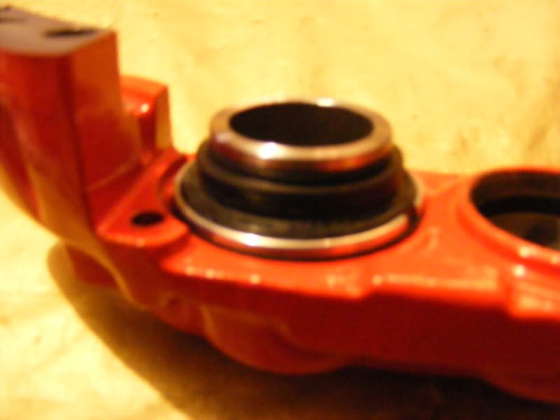

Then insert the piston into the cailper chamber
Then put the C clip round the the rubber seal
of coarse you need to this 4 times then remeber to put the rubber seal that go between the two halfs of the caliper before you bolt them together
Simples!

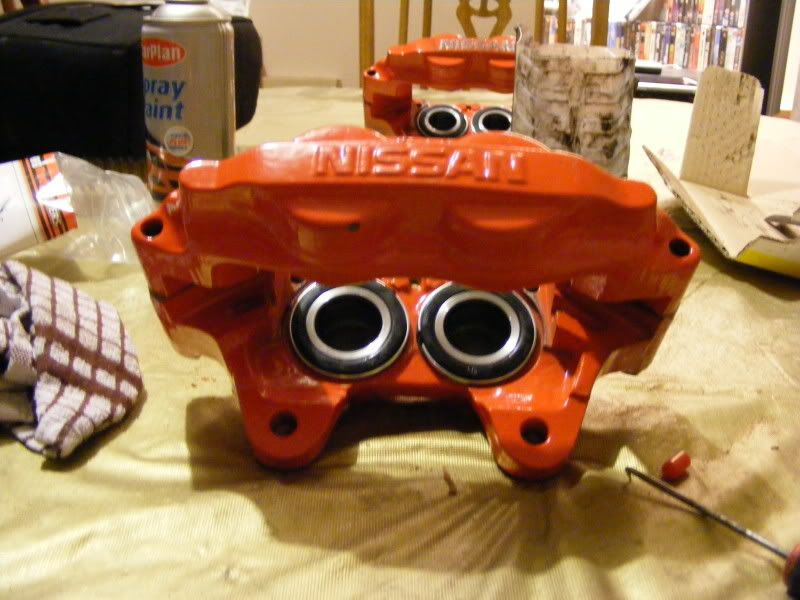

only cost £40 for the pair which i thought was cheap. There masking up was not the best but that might of been down to me not explaning what i meant.
looking good, Have you chiped it already Doh!!!!!! I bet you will notice a big differance now :cool3:
Yeah i manged to chip it somehow but i was given a a spray can of the same colour to touch them up and no doubt ill chip them again whem i fit them! lol And it will be nice to have 4 pots for a change rather than the 2/ 2 1/2 i have now
