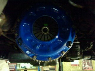

flywheel and clutch in (new rear seal and spigot bearing)

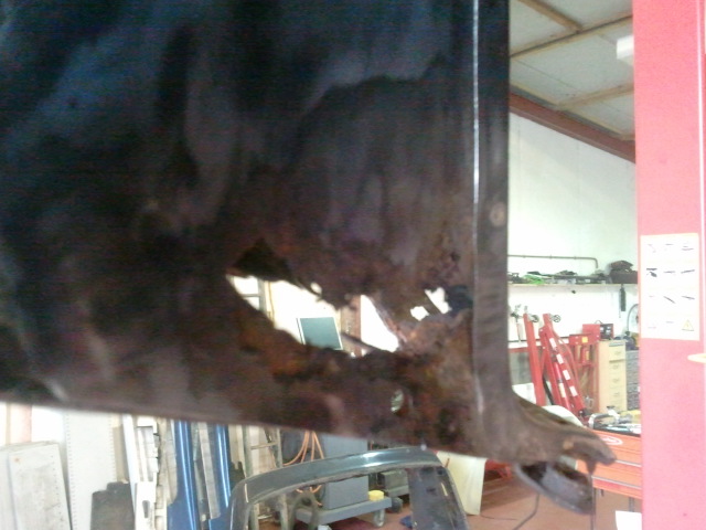

Rot!!!!!!!!!

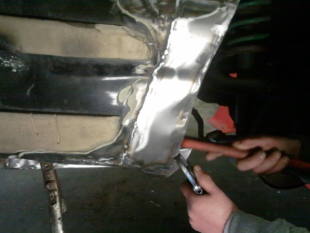

Fresh metal going in

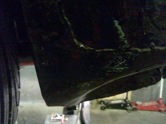

done and treated

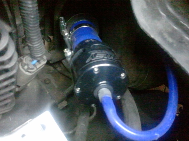

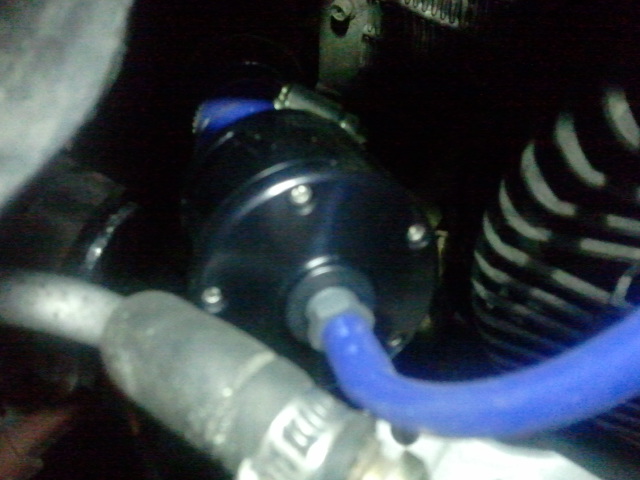

bailey dump valves

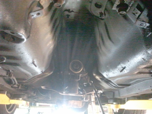

Got here back last night mate, drives and feels soooooooooooo much better, and its a hell of a lot quieter now shes so 'ventilated' underneath.The corners behind the rear wheels had gone in a big way and were far worse than the pics look but mark fabricated them all and got them spot-on.Also had a patch each side in the area below where the targas would leak and the front crossmember was full of holes and cracked and thats all been fabricated,welded and treated.All the welded areas have been coated with hammerite then undersealed and the old girls having a gallon of waxoyl pumped everywhere next weekend.
on the ramps
