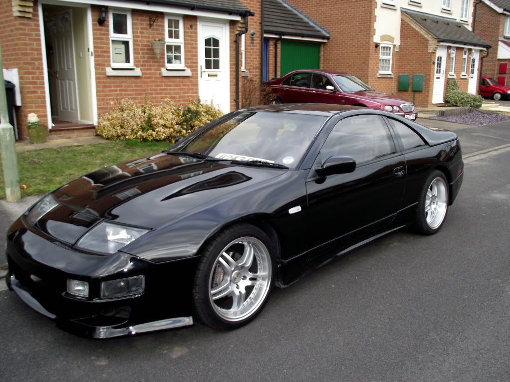

Well, since the zed has managed to accumulate a load of swirls in her 20 yr old paint work and having stocked up on a few detailing bits and a new rotary I though that it was time to practice on the old scoob before i let myself loose on the zed.
So... the car before i started:

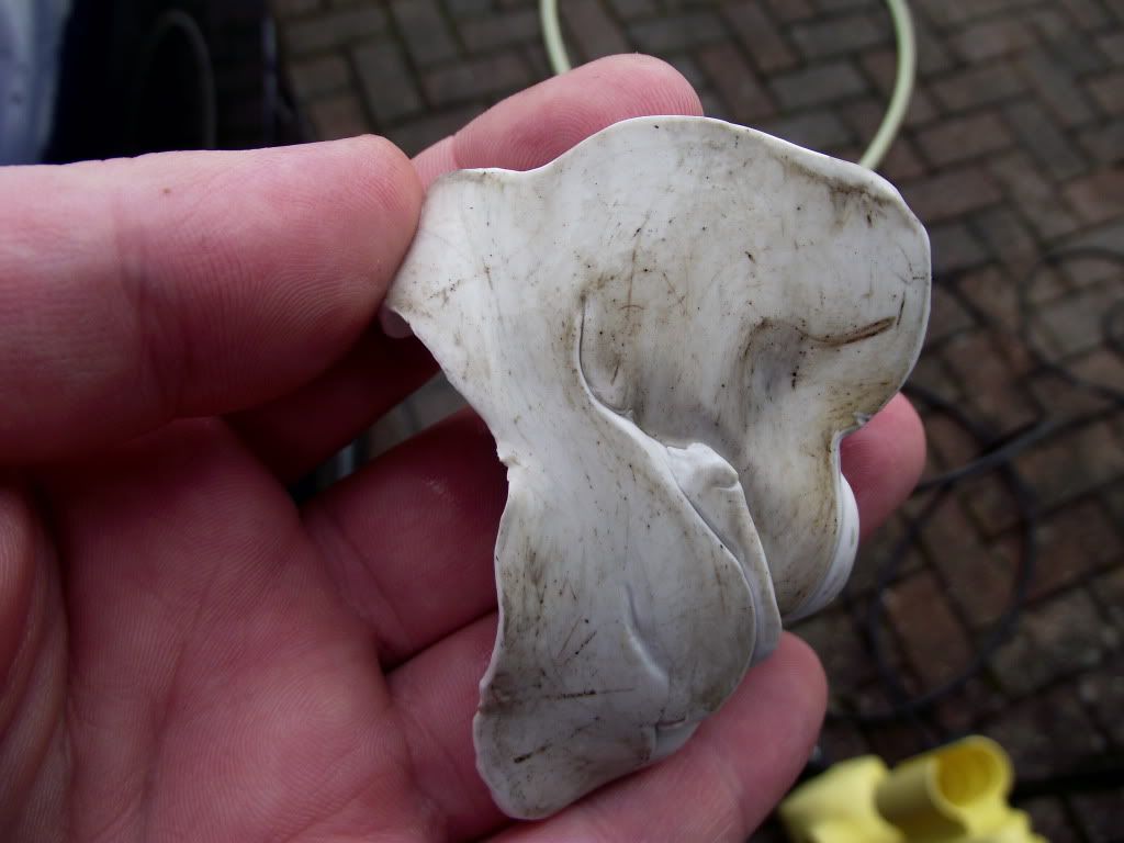

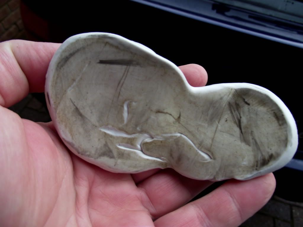

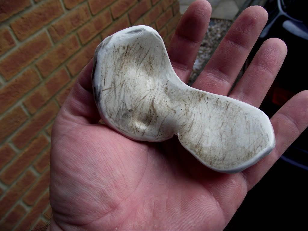

First i had to wash her, so with the trusty 2 bucket method, I went over the car..... The colour of the water was sooo black that i instantly washed her again. It was at this point that i started to clay the car since I hadn't done so since i bought it...... Well i cannot believe the crap that came off... I ended up using enough clay for 3 cars!!! and I won't be using it again I might add!
Well i used so much detail spray and clay that i had to wash her again.... so that's 3 washes now.

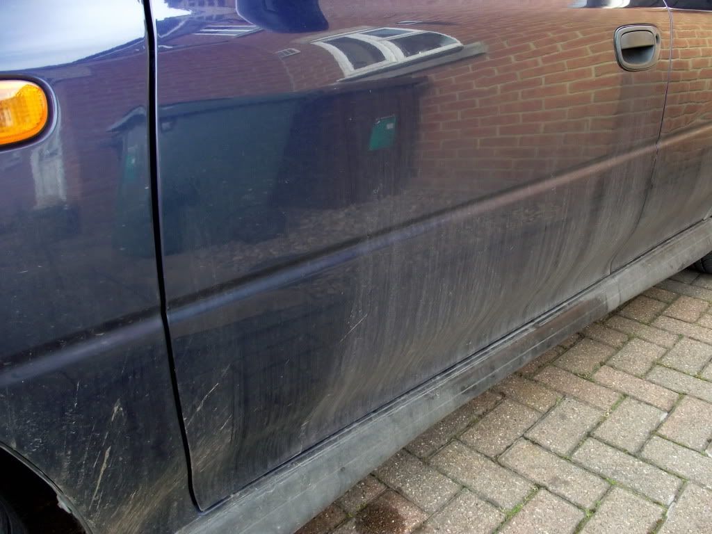

Door panel before i started.
After a few passes with the compound and a quick going over with ultra-fine finishing polish and these are the first results:

very good. clay bars are great things. problem is once you have done it once and its super smooth you always want it that way, and its not going to happen :lol:

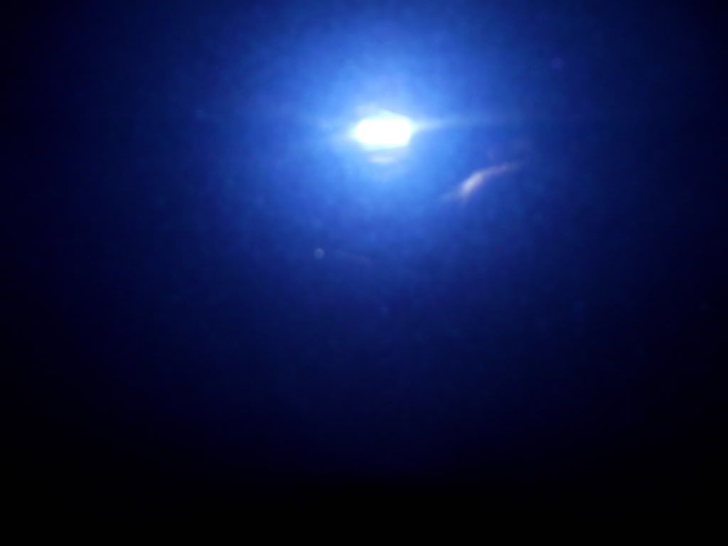

As you can see there were a fair few to deal with:
After the Meguiars compound, I then moved on to a finer polish. It was by this point in time that i had truly learned the most important lesson of the day.... USE DECENT PADS!!! The ones that came free with the polisher were shite and kept falling apart making a hell of a mess with tiny bits of foam flying everywhere.
So after a few passes with the 2 polishes, i was left with this:
As you can see, most of the swirls have been removed... not perfect by any stretch of the imagination... but definitely much better.

Clay... An absolute must in my opinion. You would be amazed at how much crap your car picks up. (I should have used some tar remover really... but i didn't have any left) There are various clays, from aggressive to mild. You do not need to spend a fortune. http://www.amazon.co.uk/gp/search/ref=sr_nr_scat_248877031_ln?rh=n%3A248877031%2Ck%3Aclay&keywords=clay&ie=UTF8&qid=1329334167&scn=248877031&h=5b5ca38e4d52f789f4900690c2d30063087ec1eb The Bilt Hamber stuff is awesome and VERY grabby, good value too. You will need some lube, or detailing spray though.

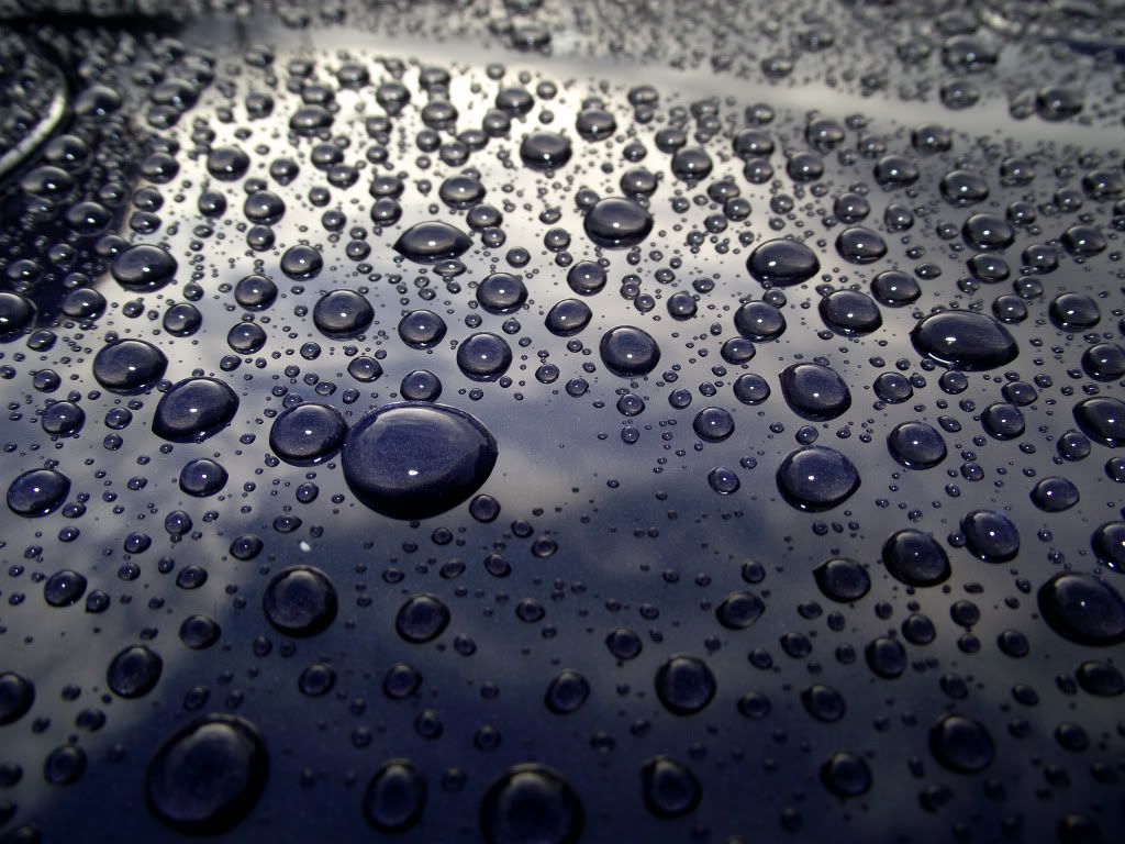

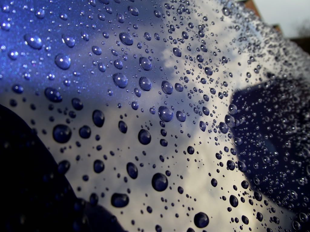

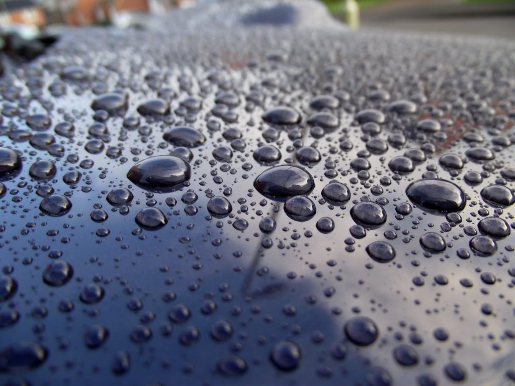

Just got back from a few days away and came home to see that the Dodo Juice Supernatural Hybrid Wax has left some nice beading, so for those of you who are interested, or for those who like a bit of beading:
