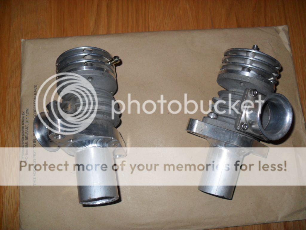

One of my Arc bov hard pipes has one pipe blanked off already so no need for a bung
to that end I've got to get this:
to fit either the drivers side
or the passengers side
and then get a second hard pipe fab'd to fit the opposite side tomorrow

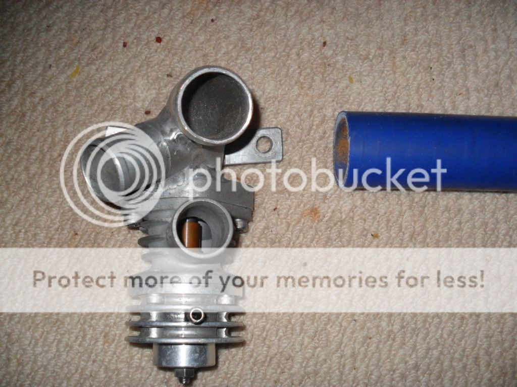

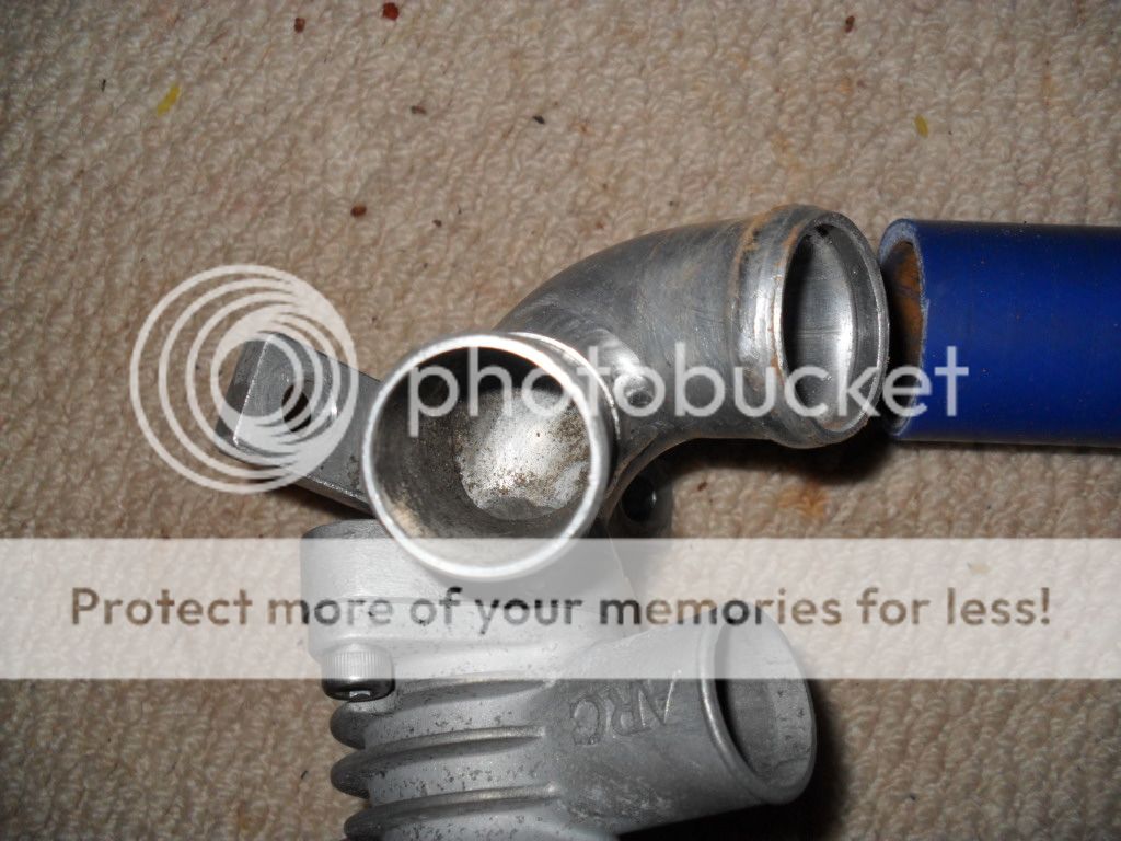

so why have they got 2 inlets plus out air
cuz normal Bovs only have 1 pipe inlet
The one is blanked off (ie. just a bit of pipe welded on)
I only realised myself about 2 minutes before I posted the thread....one of those 'aahh I see....that explains it' moments
looks like they have been used on another car ... to be a direct replacement for REC's ... no add on blanking pipes

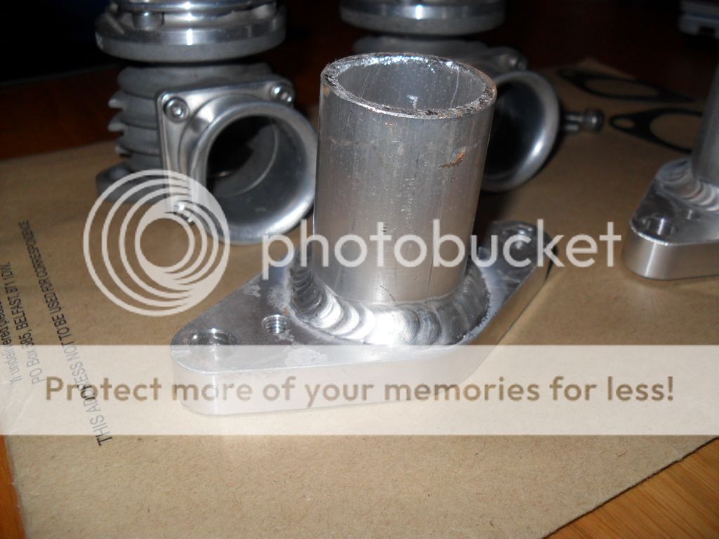

Yeah this one is for an S14
I've got two others that were on a duel hard pipe, which came off an R34 GTR
like a div'....as per usual I'm trying to do things the hard way
I visited a mate who owns a scrappy in Hereford and he steered me towards next door to get some custom hard pipes fabricated...the guy did both there and then and only charged £15 all in
here's the result
I'm well chuffed with them, so plan on fitting these tomorrow.....just got to find two bungs now
