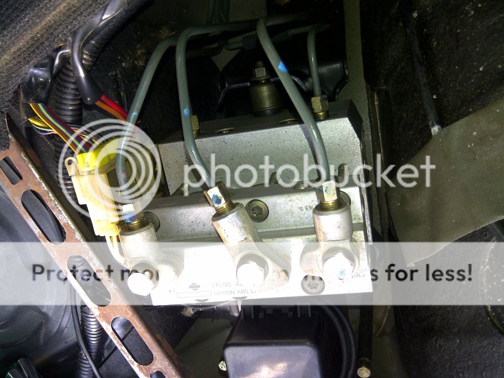

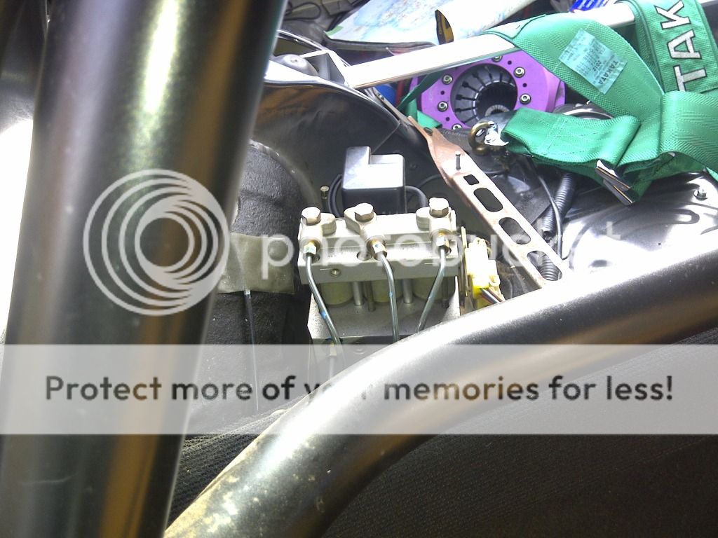

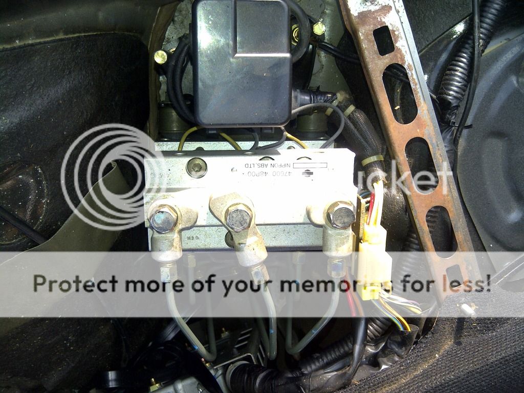

This is on a SWB TT which has a very different ABS setup to that of the LWB TT, the unit looks different and there appear to be more lines running in and out (none are marked as to which is which)
are we talking 'T' pieces or does the ABS need to be removed?

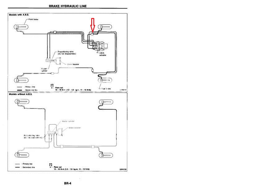

Here's a diagram from the manual showing the brakes lines and ABS, may help you out;

and I'm assuming that it's not just as simple as dis-connecting the top row of pipes and connecting them up to the coresponding bottom row of pipes (thereby bypassing the actuator altogether) and plumbing in a 'T' piece for the hydraulic handbrake lines to tap into?

Also I will be doing this job on my SWB at some point plan on doing the same as I did on my beemer. You can see on the diagram Steams provided that there is a single line that supplys both rear wheels via a T piece.

I assume this is the point that you mean mate:
where would the return line going back to the hydro unit tap in?
Tap in and out at the same point. Remove bit from ABS unit to that T piece. Plumb the line from ABS unit to Hydro IN. Then plumb Hydro OUT to the T piece. When ABS is functioning it just works through the hydro as usual. When you pull the hydro it acts directly to the rear wheels.
