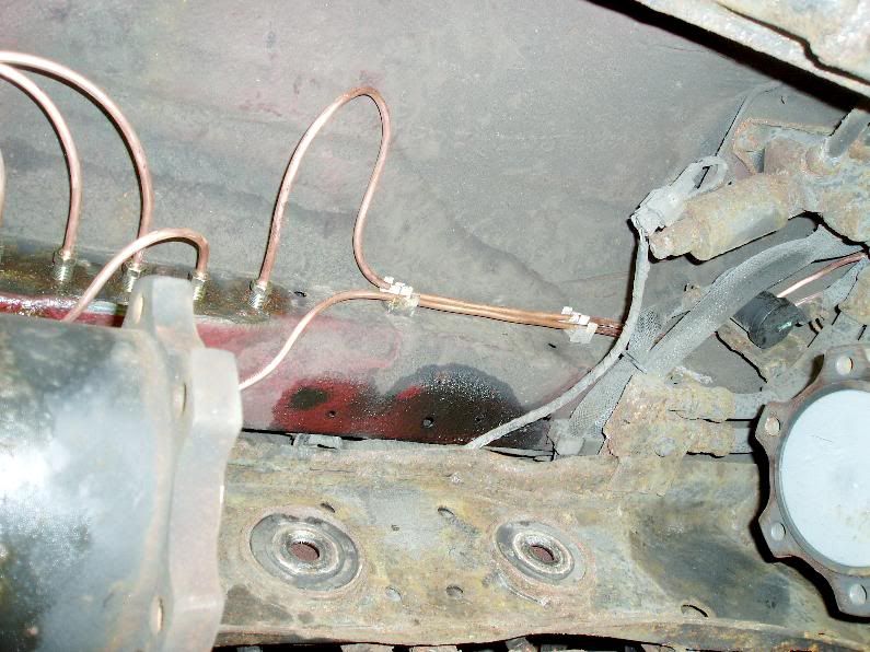

Rear brake pipes can be a pain, tip though, no need to remove the subframe just remove the diff, picuture below of one we done some time ago shows the access with the diff removed, neatness is the key, the original fixings need to be reused so the tester can see they are all secure.

Thanks Jeff, handy tip that one, we'll have a look tomorrow to see how bad things are.

thanks jeff, that looks alot less daunting then taking the subframe off lol

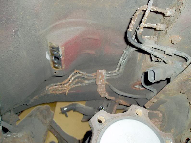

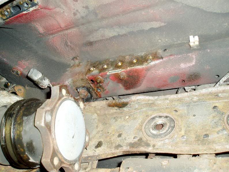

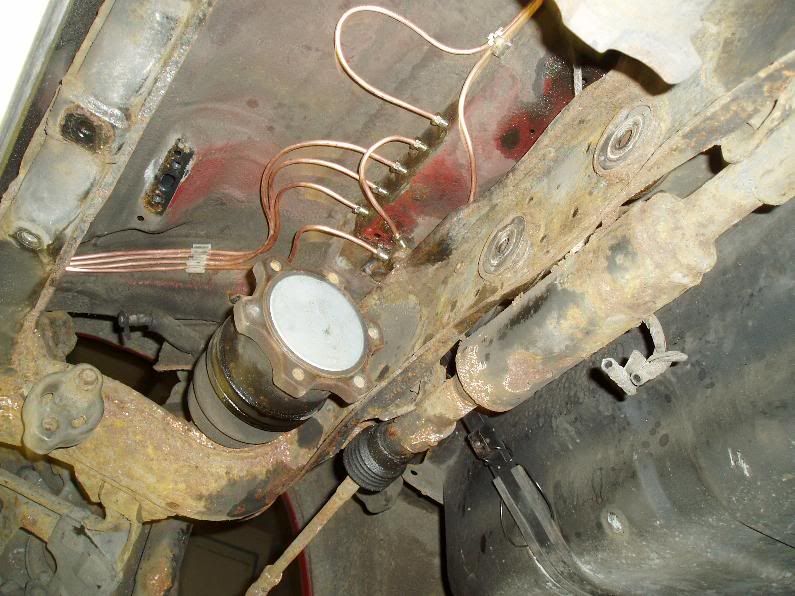

Here is another one we did, you can see how bad the original pipes were, again removal of the diff was enough, a few pipes do need to be threaded through to get them in, draw a small diagram to remind yourself where each pipes goes before you remove them, and remember the whole system needs bleeding, starting with the ABS module first.
