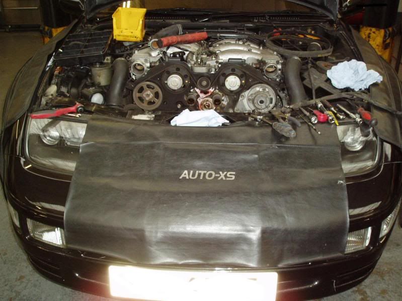

The zed below was in for a cambelt replacement, no drama, sounded ok so stripped it down.

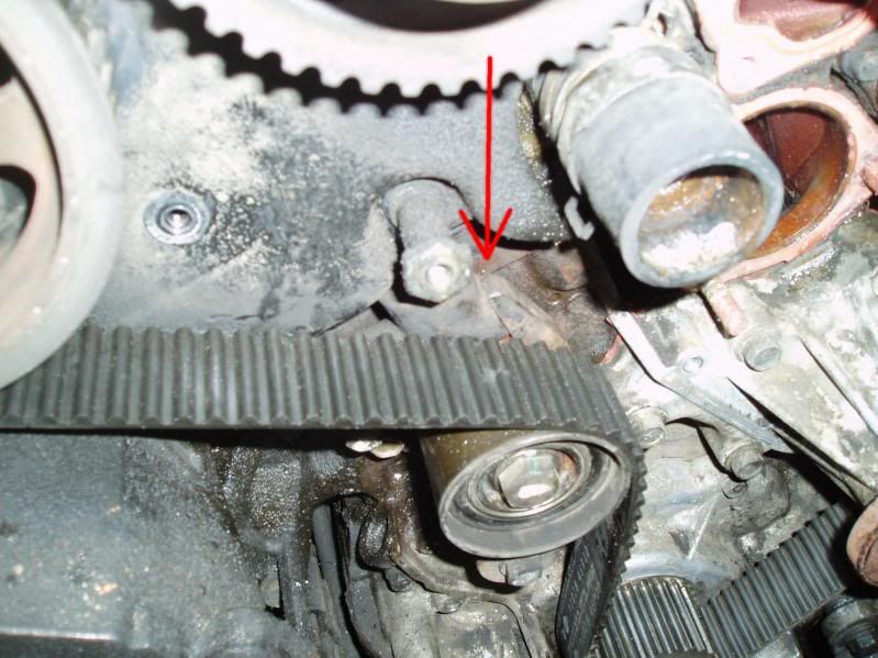

Once stripped it was clear the auto tensioner was stuck and not applying any tension on the belt.

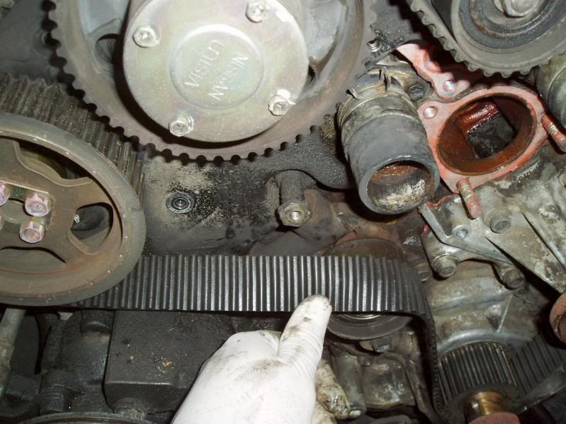

The belt had as normal streched since installed but without any tension was so loose you could pull the belt off the pulley.

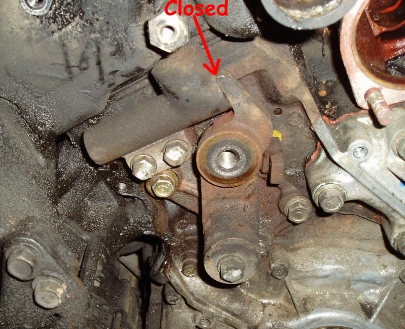

The adjuster can be seen here to be closed, it should be wide open with no belt on.
