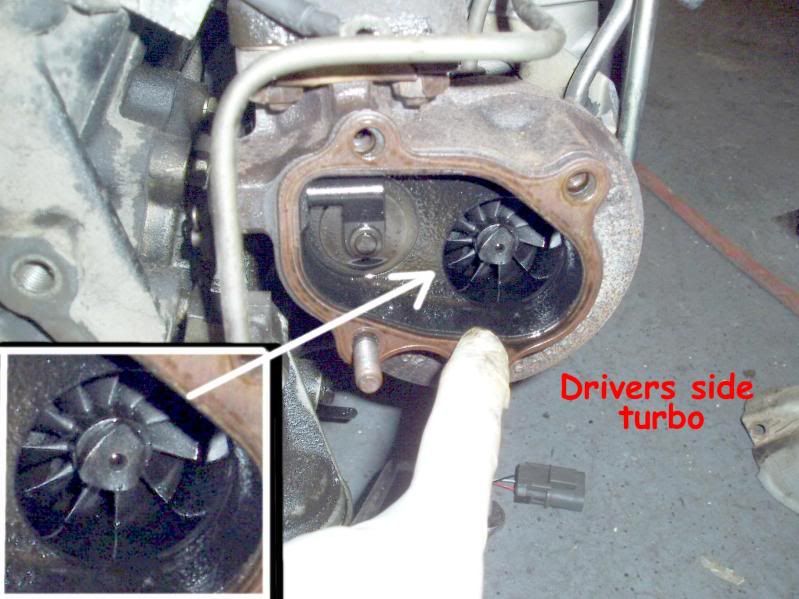

Fast forward to now the owner decided to get it done, so whilst we tested it the smoke would have made James Bond proud!! we knew something was very wrong.
So engine out!

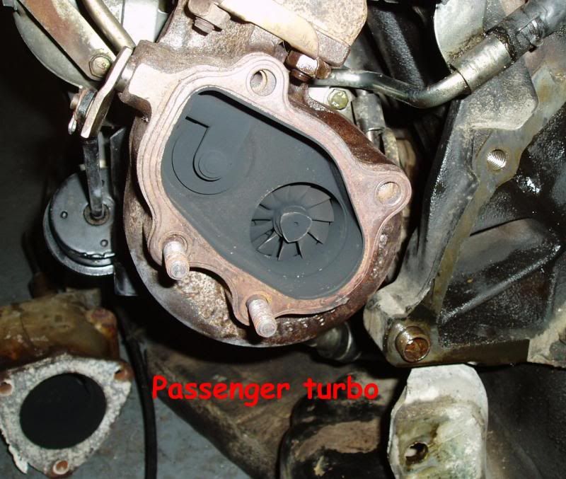

Passenger side turbo looks a bit sooty but fine.......
But the drivers side turbo was wrecked, difficult to see in the picture but the shaft was wobbling all over the place and as can be seen the oil seal had let go!
The front of the turbo implellor had suffered damage from the excess shaft movement and basically is in need of a full rebuild....again
So a detailed investigation by the tubo company has revealed the shaft journel to be completely coated in metal transfer, it transpires that under closer inspection they could say 100% the failure was due to low oil pressure not no oil pressure as is often the case.
So looking back, the original failed turbo was on the same side of the engine, and with the passenger side turbo in good order we checked the oil feed on the drivers side not the pipe but the block casting, nothing to be seen but when we tried to blow compressed air through it was clearly restricted.
