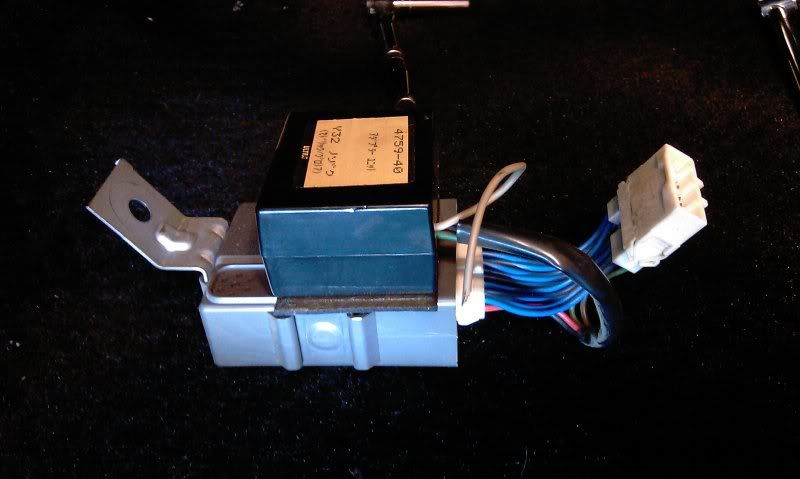

Is this a turbo timer? found it while installing the clutch pedal. As far as I was aware it did not have a turbo timer and definitely didn't work. What is the grey wire? take it that's why it doesn't work. There is no other wire anywhere nearby that that grey wire could have been connected to.
Any ideas?
It is taped onto that grey box and has some sort of cable that goes between the grey box and original wiring.

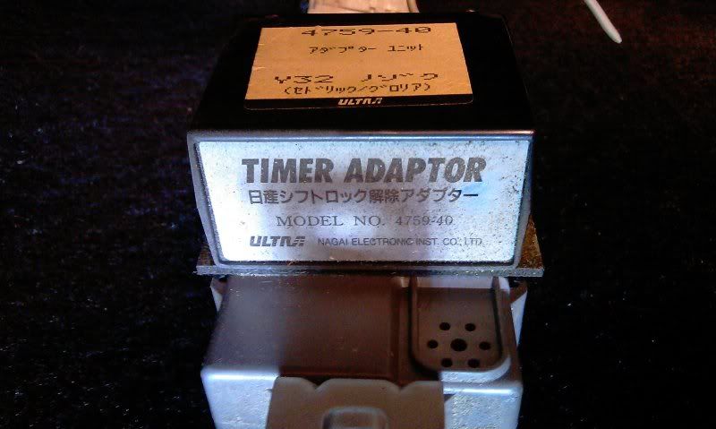

Just done a quick search in the net and it appears to be an adapter that plugs into the cars existing loom, and then you plug an Ultra turbotimer into the adapter
Would appear you have the adapter itself but not the actual turbotimer unit that goes with it.
RHDjapan have got them on their website :)
That was quick thanks. At least i know i can now just get shot of it.
