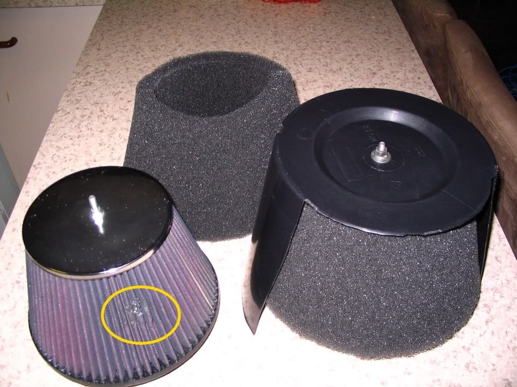

if its a cone filter there is a mod you can do that involves a plastic plant pot lol

shouldn't matter, i have no top or bottom seal and mines vented, i have a hks cone filter similar to the apexi one i dont suffer issues, go get a plastic plant pot and rig it to cover the top and front of the filter with a cutout section for the bottom of the filter

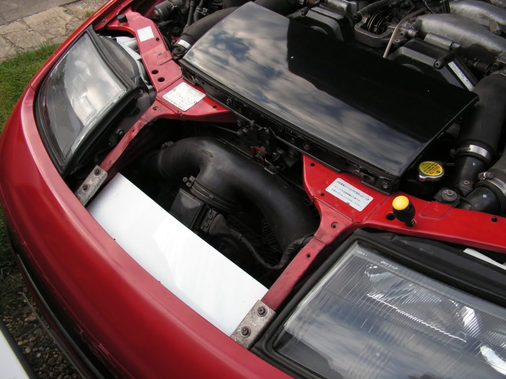

I have both seals and i had this problem. My filter would gather water in the bottom of it. I did tests with pieces of paper, putting it under the nose panel and spraying the hose on it. The water was getting between the bumper and the nope panel.
This is what i done.
Not had the problem since.
Sheet of plastic, not even bolted down, looks like crap but it works
