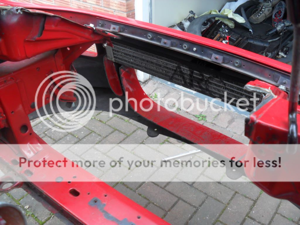

I'm going to switch front bumpers on the shortie' and was thinking of running the Arc oil cooler along the top of the greddy fmic and was considering fitting an additional larger Calsonic in the stock oil cooler position, ready for when I fit the new engine. I just figure that I should make allowances for a second cooler early on, should it be required later on down the line

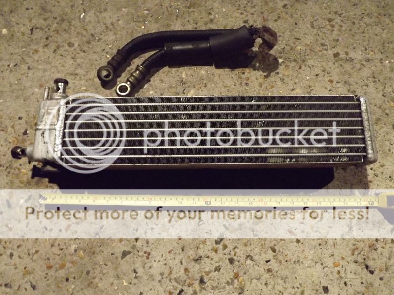

The only possible issue that I can see is that the hoses are sized to fit what I believe are pretty large ID hoses (the connector is just shy of 50mm ID) so whatever that is in AN fitment?

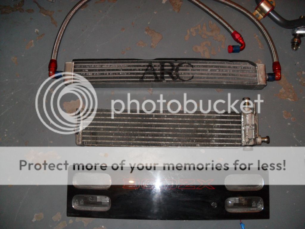

Centre light panel to give an indication of cooler size:
I would ditch them both and get a decent size 19row oil cooler instead.
The charged face size on them is smaller than the stock UK cooler.

I figure it would get much cooler air if located here than if it was behind the fmic
the idea of having a second (calsonic) cooler located in the stock location was to increase cooling again on fairly long track sessions (if required???). Alternately, if not used as a secondary oil cooler then maybe it could be used as an upgraded PAS cooler instead, if that makes sense?
