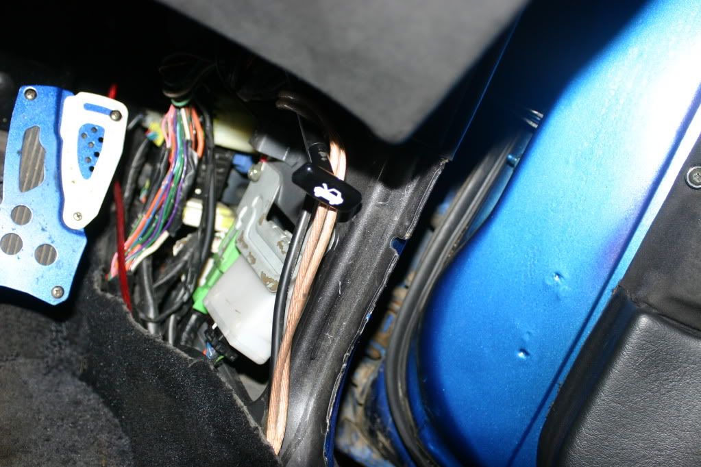

For a quick fix i unplugged the white box that controls the timing functions on the car (kick plate near the fuse box in the drivers foot well, ill up load with photos in a bit)

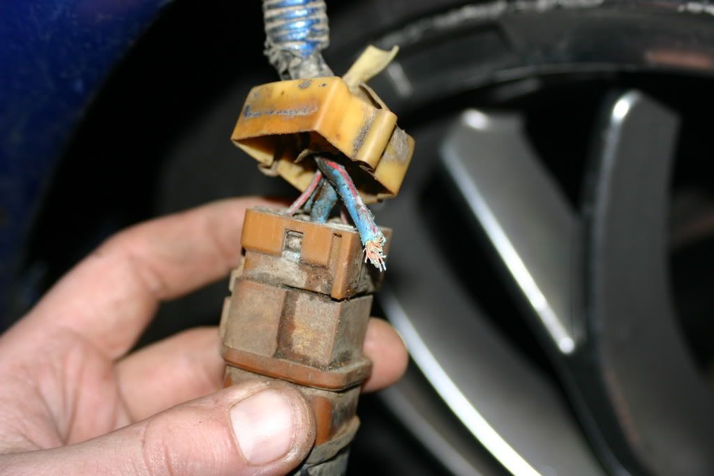

Next up was the drivers side wheel arch, in the arch is a relay that normally sits behind the wheel arch liner (opposite the water bottle for the windscreen jets) pulling it out i noticed with the white box plugged in, it stopped the wipers, a bit of playing with it, it made the wipers do a few swipes. so considering the condition of it (caked in crap) i gave it a clean up as best i could jumped back in the car, and also managed to cure my intermittent wiper problem at the same time, once i figured out that i had everything working, i pulled it back out again, only this time i found out it was more than crap build up that was stopping it working correctly

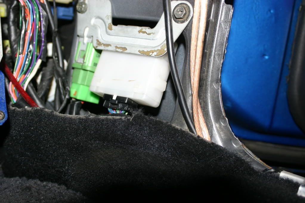

this is the wiper timing control box (white box), it also helps with the dimming of the dash, so once unplugged you will lose your dial lights.
This is its location in relation to the drivers accelerator pedal.
and a close up for you all (mind my dodgy wiring)

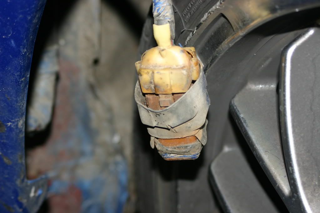

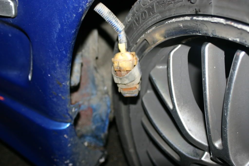

This is the offending relay after being pulled out from the wheel arch
and a close up so you don't get confused lol
The cause of my loss of intermittent wiper, and then the fact i couldn't turn the wipers off.
at the moment I've left it like this but cable tied a bag over it to keep the water out until i can get new relay holder, i might even relocate this as it seems a bit of a stupid location for it to be.

With the wire out and the bag over it, i get the use of my wipers back, but with out the intermittent function again. once ive fitted a new relay and relay connector it should all be working how it should be.
