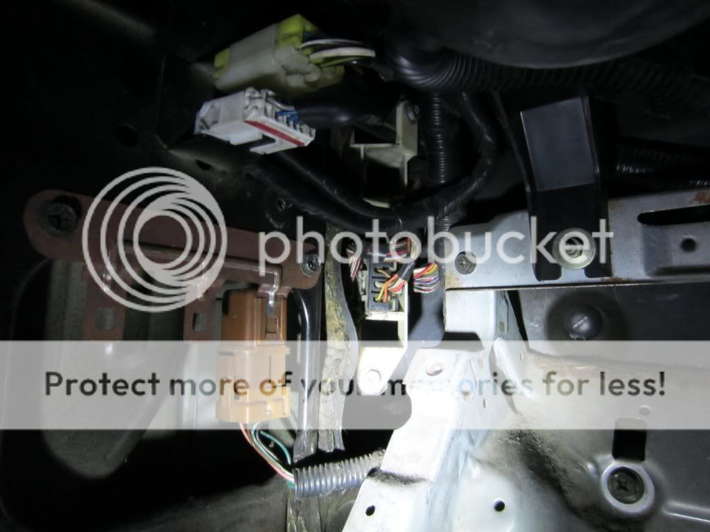

Just repairing some electrical issues with the old Z and needed some better information:
does anyone know which connector the horn is located on in this pic?
also on other pictures i have seen, there is a black connector next to the big brown connector. Am i missing some wiring?
Does the water pipe for the targer come in around this area, i cant find the pipe

1 ) does anyone know which connector the horn is located on in this pic?
2) there is a black connector next to the big brown connector. Am i missing some wiring?
3) Does the water pipe for the targer come in around this area, i cant find the pipe
cheers
1 The horn cable connector is located on the steering colomn half way down on the silver bracket
2 Due to multi fit looms and option differences there is sometimes spare plugs
3 The targa pipe is behind the fuse box, this needs removing to get access, link to how to thread with pics here: http://www.300zx.co.uk/forums/showthread.php?t=146736&highlight=targa+pipes

cheers for the replies.
I take it the passenger side drain plug can only be found by taking the wing off then?
so the horn cable comes straight from the engine bay fuse box to the steering column?
Think you can get to it by taking out the arch liner. So long ago that I have been in that area. But I would try the liner first
No need to take the wing off, much easier to take the fuse box out, see the link in my previous post.
Yes the horn cable comes from the steering column to the relay under the bonnet.
The horn cable is an earth return not a power cable, if you have a cable issue between the steering wheel and the relay which I have dealt with several times the easiest option is to just pull a new cable through rather than waste time looking for the fault.
