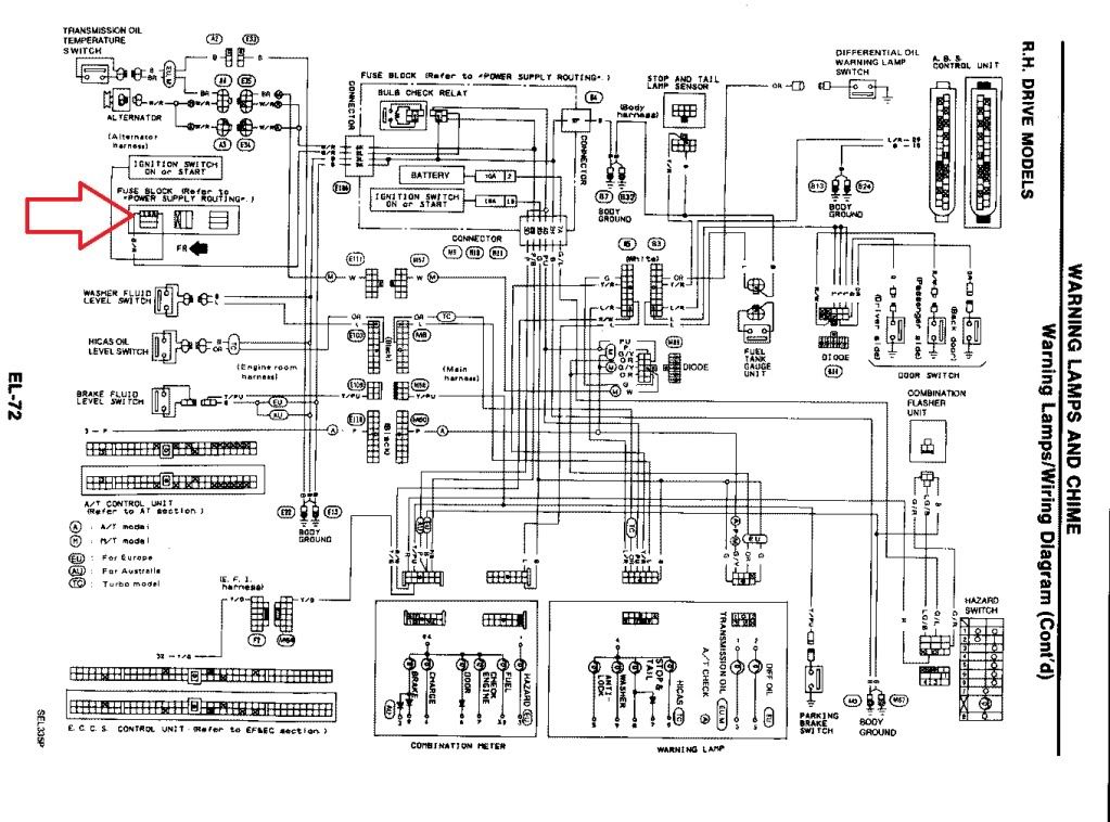

weres the eng cont fuse on the drawing?
If im reading this correct, then the fuse is located at the tip of the arrow, though im sure it says 13A, which would indicate a 13amp fuse surely, but there isn't a 13a fuse in cars. (can be found on page 72 of the electrical section of the service manual. really not sure what to check or where to check for continuity though, car can be driven just likes to die, i dont loose any lights or anything, i just end up with LIGHTS and DIFF OIL lights lit on the dash cluster and the car idles at around 640rpm and wants to cut out.

from what i can make out id say it powers the bulb check relay which looks like it switches the fuel injection system which would explain your idle problems i guess, it looks like it feeds a lot more than that though as its also looped to another 40 amp fuse ill trace that through in a min it could be as simple as the relay coil is knackered as thats all that fuse feeds by the look of it
copied from the Aus site

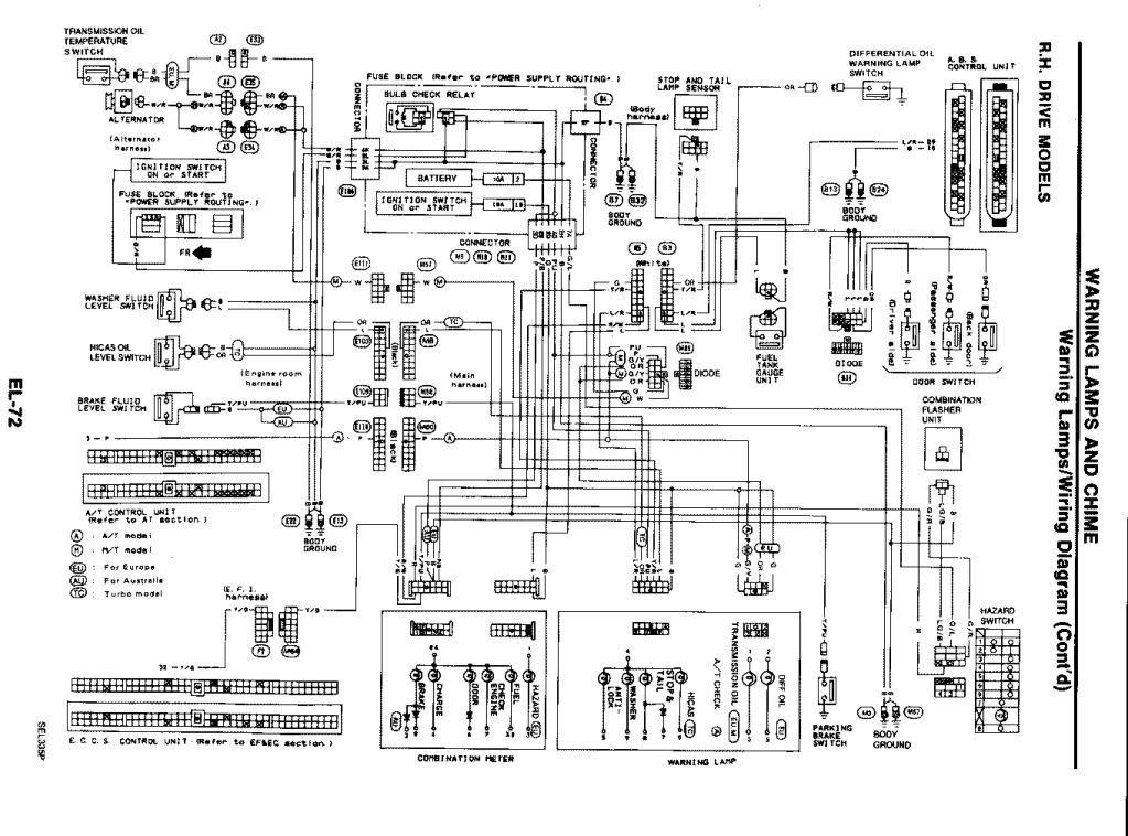

looks like the eng cont fuse does a lot more than whats shown in that diagram.
ok i rekon check the smaller connector of the two connectors that go into the warning lamp part of the circut ( bottom right ) as if the wires on that were shorting youd get all the lamps you mentioned light up when you replaced that 13amp fuse also there must be a problem with the bulb check relay as unless theres something else being fed off of the fuse thats not on the drawing the relay coil is the only thing being powered by that 13amp fuse
thing is its not a 13amp fuse in the engine bay, its a 10amp and even says so on the lid, lol bloody stupid cars.
ha typical weve got no hope if the drawings ain't even close!!! lol
