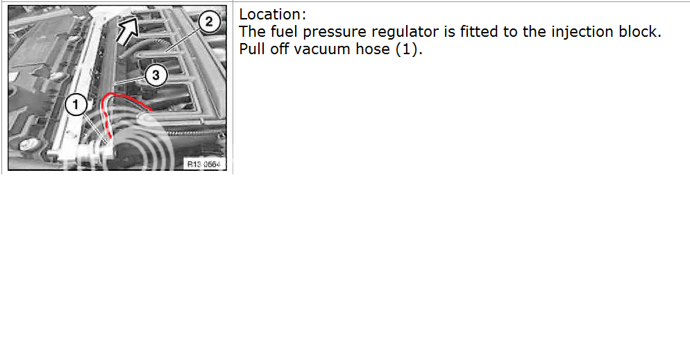

Ok guys, it's a 2000 323i, and I need to know where the end of the fuel pressure regulator vac pipe goes, in red on the picture...
I have tried all the usual things, forums, service manuals etc. no joy, seems no-one can tell me/show me where it goes, and to remove the plenum/intake manifold means disconnecting the fuel lines, which seem impossible to do with the engine in as they are at the back of the engine, zero clearance, and I have little bitch hands....
Cheers, Tudor....
Tudor .It goes on to the bottom of the inlet manifold by the idle control valve.If you remove your intake pipe you may just get to it by feel as its not visible with the plenum on :)
