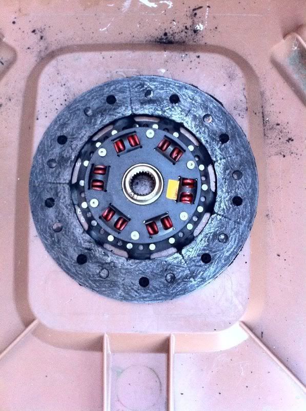

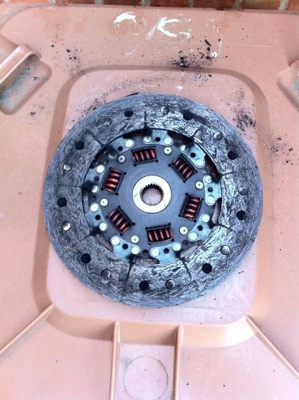

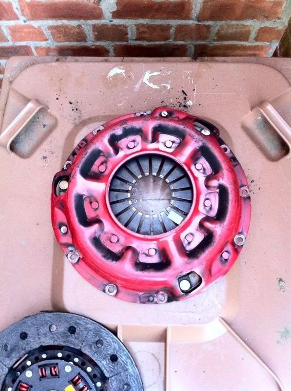

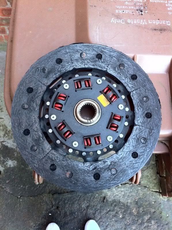

I need some help. Below is in RPS street max clutch. As you can see it's bust. I want to know what it needs to be back to normal. The disk is an abvious one and has no material left but does the rest of it look fine?

by the looks of that, you just need to clean the clutch housing and fly wheel, and replace the clutch plate.

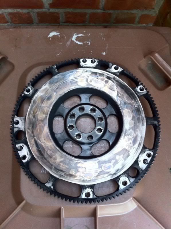

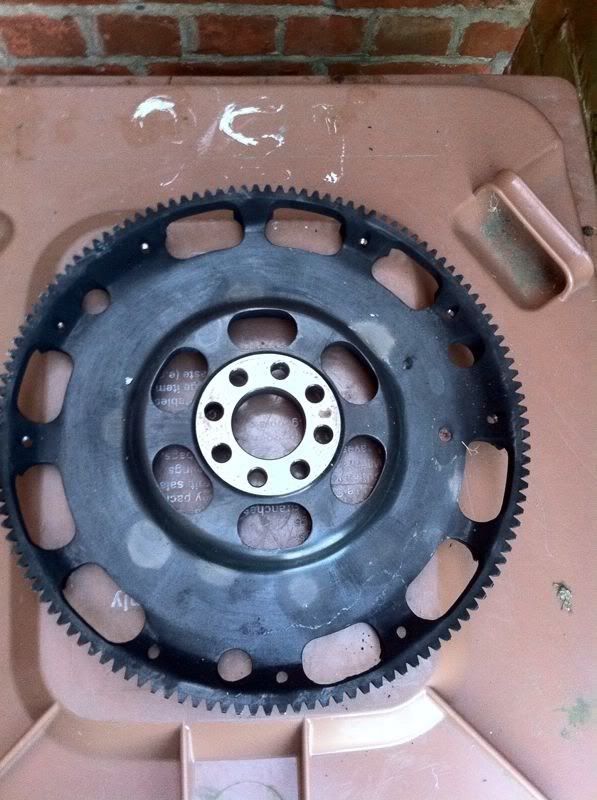

I have an rps segmented flywheel in the car. I'm I right in thinking pictures 2 and 3 are of a flywheel??? If si then I don't even know why it's there unless it's something that came with the clutch.

Picture 1. is the clutch housing
Pictures 2 and 3. are flywheel
all the others are the clutch disk that wares and causes all that lovely clutch dust.
Just to give a little background on this. The clutch was pretty much new and failed very early which seemed to be down to a couple of lips on the sedmented flywheel... Don't know where these came from.

Thanks mate. So we think it's just a new disk thanks needed then?

check the flywheel face for anything thats going to cause excess ware, its essentially like a big brake pad and brake disk, so anything on the flywheel pressure surface that could impact the life of the clutch friction disk, is going to shorten its life.
the disk might not be holding up to the amount of power your putting through it. what BHP are you running?
might also be an idea to check the fingers on the clutch housing as these press against the clutch to engage it

The fingers all look completely fine but like I said it was hardly used really

well then, based from your original question, if the contact surface is fine with nothing thats going to accelerate the wear on the friction disk, id say replace the friction disk and you should be all good matey.

I also bought a rebuild kit for the flywheel... Basically got new segments
