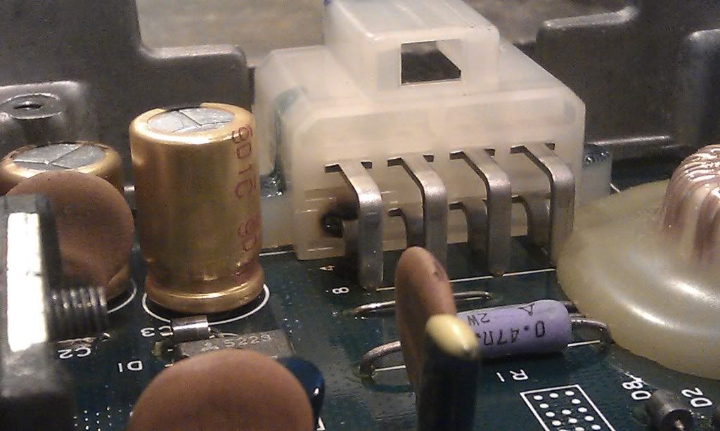

Got round to doing the fuel pump ecu modulator, wasn't as bad a job as i was expecting, here's what i found on the old one.
Top right pin a little black and burned, and the connector in the plug didn't look to healthy either, it still gives a good connection after a clean up though. tested the resistance to one of the other pins so convinced the cable is ok.

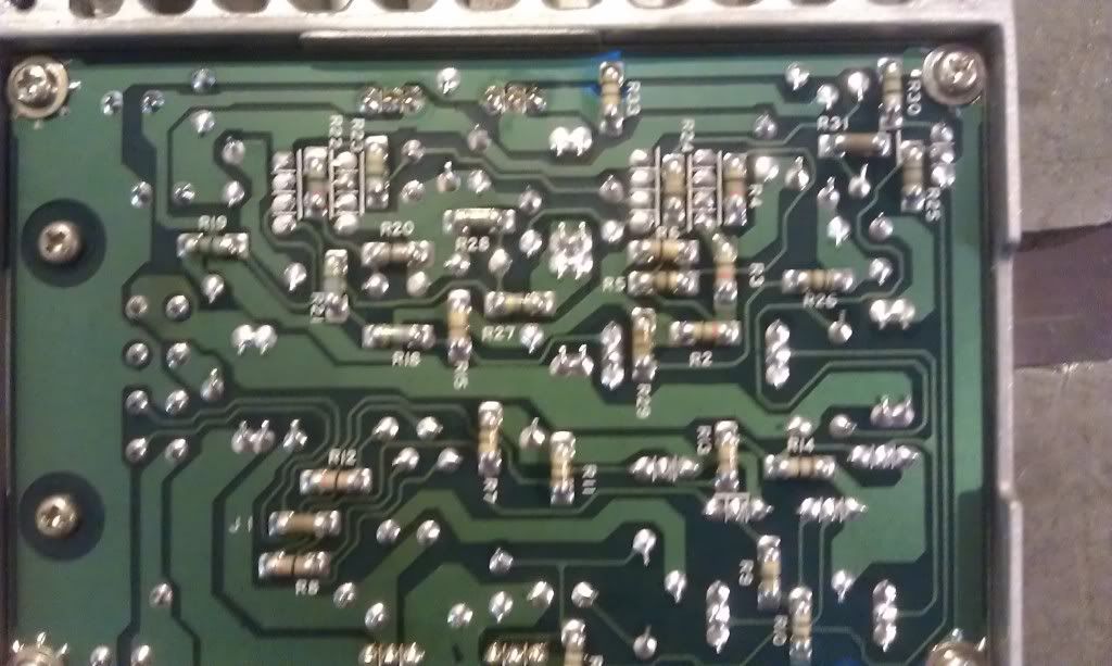

Took the old ecu apart to see what it looked like inside and to be honest it didn't look that bad, i was expecting a nasty smell and loads of black shit but it basically looks like its just that one pin that's gone tits up. nothing else seems to be at fault.

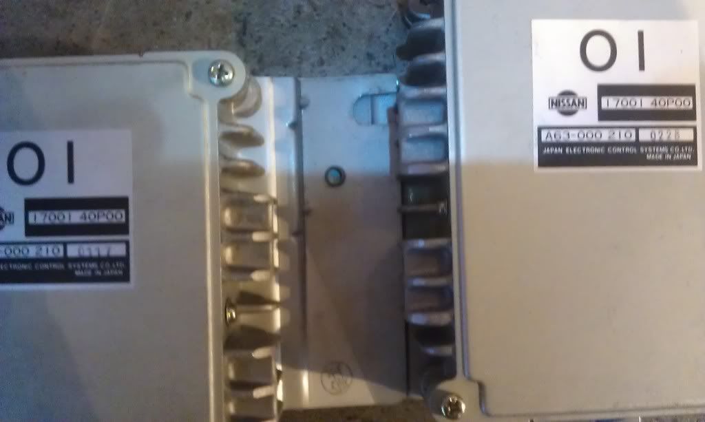

and also a spot the difference.

I give up on the spot the difference, I'm never any good at them. I could never 'spot the ball' either :(

as for the spot the difference the bottom right number is different, I thought it was a manufacture number meaning the new one is 111 units younger than my old one.
